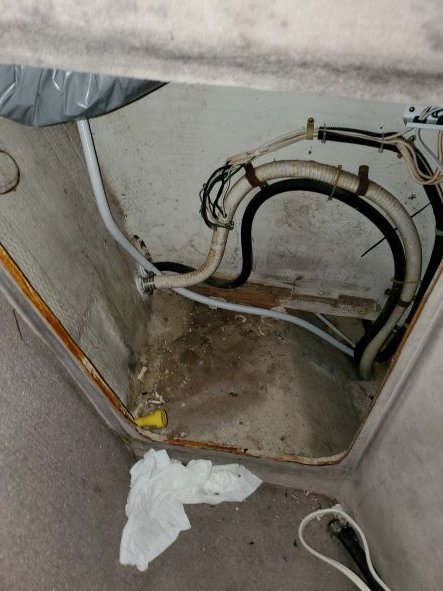

On the 12m sedan access is through a panel in the back of the starboard locker. Picture is of the space during the replacement of ours (picture is turned on it's side for some reason):
