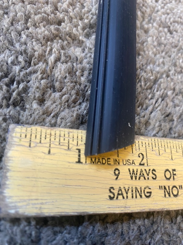

Install the trunk gasket

Image is trunk gasket
