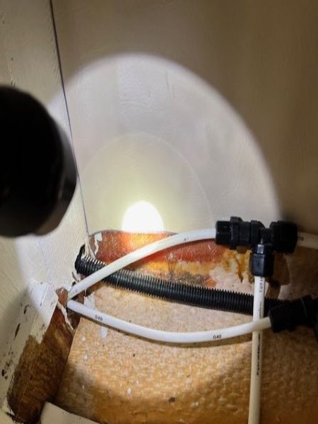

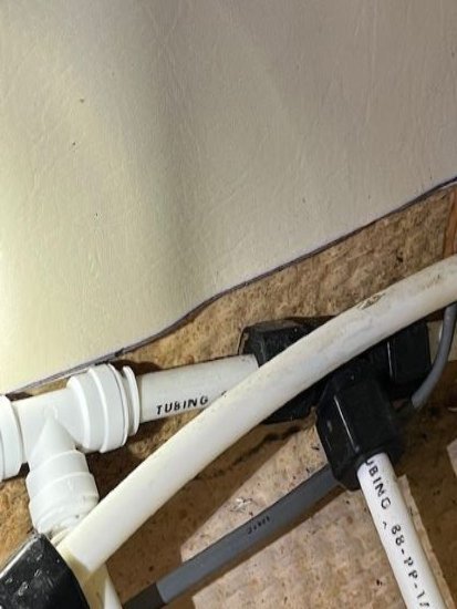

mrrudely wrote: Wed May 22, 2024 7:59 pm thanks for the pics
but I cannot tell where I am looking
can you give me some reference?
I don't know what the bolster board is
thx
rr
mrrudely,
I'm sorry for the delay in response and for the non-informative pics, I know that can be frustrating. In any case if this issue still exists, the first pic is aiming at the deck underneath the bottom shelf (shelf removed) in the closet (behind the toilet). That black wire loom contains the wires you are speaking of in my set-up. The second pic is the "grey" wire in the same location as first pic, but out of the loom on it's way up and over to the DC panel.
Hope this helps or perhaps you may have found yours already.
