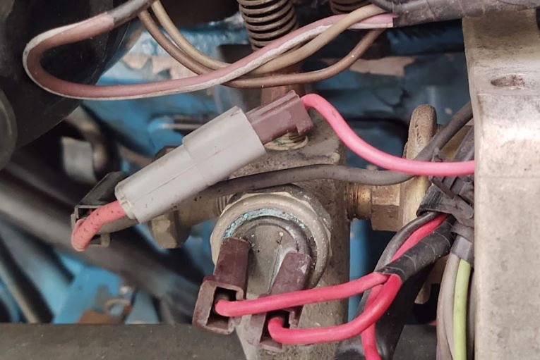

Check for power at the buzzer(s) and check to make sure the wire is hooked up to the oil and temp switches. (not sensors)
Re: Port engine wont start from bridge.Upper and Lower buzzers dont work
I didnt know about the oil and temp switches? I did notice one of the buzzers has the top piece removed from the lower half.prowlersfish wrote: ↑Wed Jul 24, 2024 11:27 am Check for power at the buzzer(s) and check to make sure the wire is hooked up to the oil and temp switches. (not sensors)

Going to check the wires and connections on the senders.
- oil sender and switch.JPG (66.86 KiB) Viewed 14638 times
