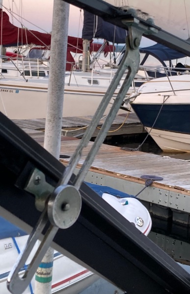

Here’s a shot of the starboard side of the starboard tilt out front window. Both windows have the adjusters on each side. Windows weight approx 25 lbs each. I’m thinking one gas spring rate around 10-15 lbs on one side of each window would ease the manual force needed to raise and not impede lowering the window

Starboard front tilt out window adjuster
Here’s the picture I just referenced

can't tell much from that close up photo
one thing to consider is the strength of the hinges
If you have a gas spring on one side only the hinges will have to be able to handle that
Also on its own a gas spring is either fully opened or fully closed
I don't know if you will be able to have a spring and an adjuster on the same side
I have often made mock ups before committing
the geometry, length, and force needed can be tricky

Thanks. Just realized my photo was the port side. I must have been standing on my head when I was describing things. :?
