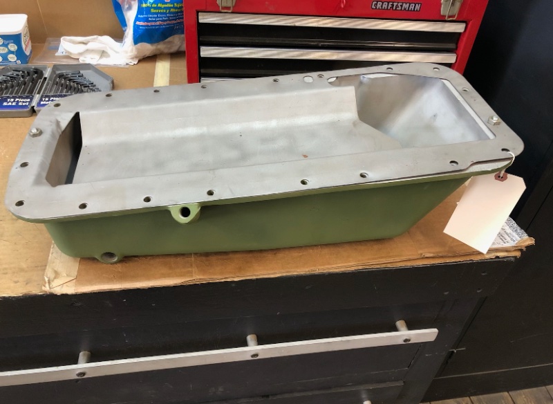

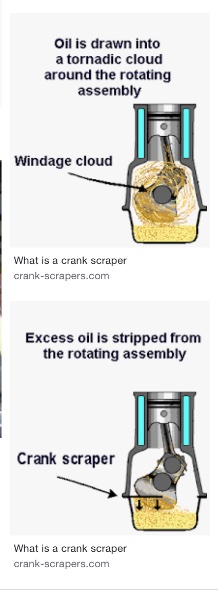

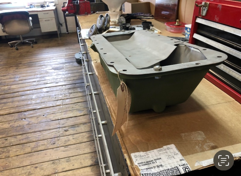

When the development of the Chrysler 360 began the engineers discovered that with the longer stroke of the 360 that a oil wedge was developing in the oil pan which was dragging back the crank shaft the reducing the HP as much as 100 Hp when engine RPMs were over 3200 RPMs. ( see photo) To address this problem they added an oil pan baffle as (seen in photo.)

The discovery of the crank wash on the Chrysler 360 caused the Chrysler engineers to add an oil pan baffle to the big block 440. Early 440 were rated at 300 HP when the baffle was added the HP went from 300 HP to 330 HP.

There should be an oil baffle in your oil pan.
With out it it robs 100 HP from the 360.
They should have been in there but if someone built there on 360 they may have skipped this part.
