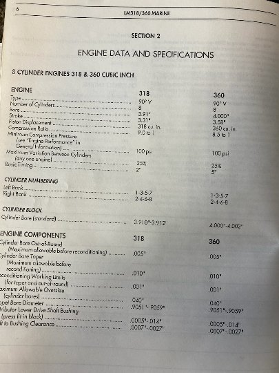

I feel one engine while having high hours still may have some life left. The boat has been used and that's a good thing. Compression while a bit low on it is still in specs. I would still want to see wide-open rpm if just for a second or 2. I don't like doing one at a time. Need more info on the oil leak.
Here is the specs you can get the manual on this site ( will post the link later)
Trojan 318.jpeg (50.74 KiB) Viewed 8966 times
