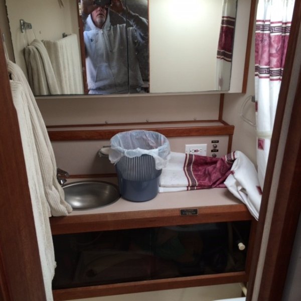

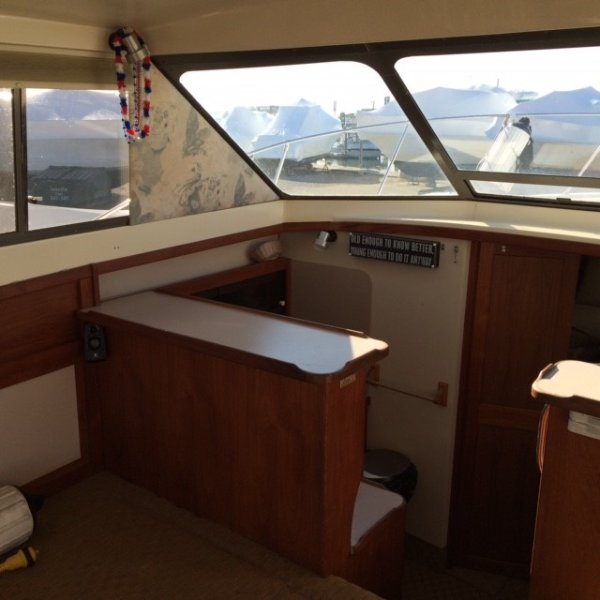

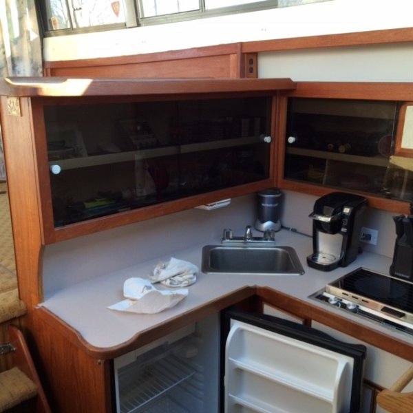

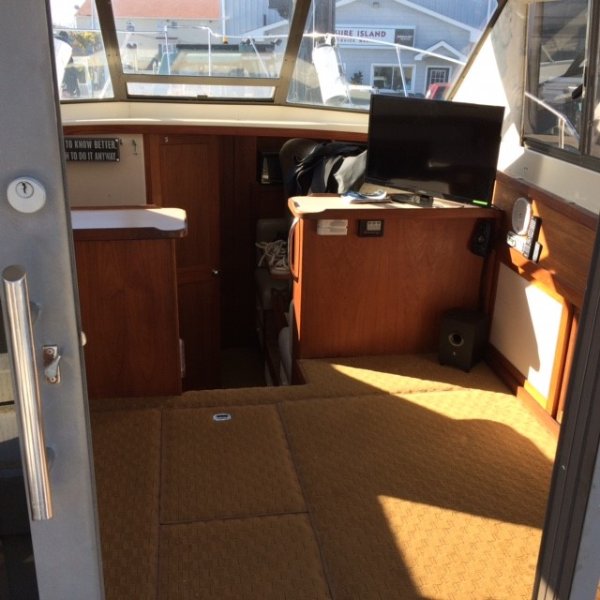

I purchased this F32 in the winter of 2016. The pictures are from the first time i boarded the boat and the finish was still beautiful. I am sure all previous owners used Teak Oil to maintain the deep red color. I have continued using teak oil applying once a year. it takes about 2 hours to do the entire job with a small cup of oil and a 4"x4" pc of towel cloth as an applicator. Could not be easier and it looks even better today than the pictures from 2016. We have since replaced carpeting and updates like lighting, curtains, furniture Etc. Such a great boat that was treated with TLC throughout the years.
