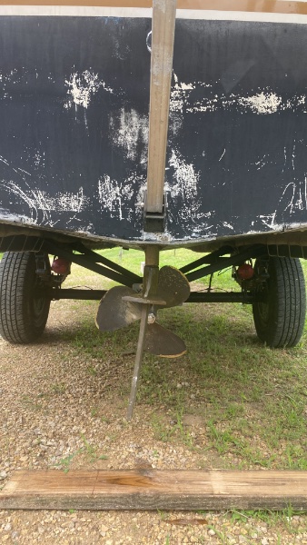

Greetings, so we got wet again this weekend after four years on land and apparently forgot how dock lines work, ended up in the rocks at the marina momentarily. Boat was in the water for a few days and operated normally, smooth steering and tracks pretty straight, no abnormal vibrations etc... When I pulled her this morning the rudder is bent to the side pretty good.
Is there a preferred method of straightening the rudder shaft? Parts readily available?
Any help would be greatly appreciated.

I would replace it , hard to get the shaft 100% straight . A bent rudder can flex the fiberglass as you turn it ,causing cracks . I almost sunk mine because of this .

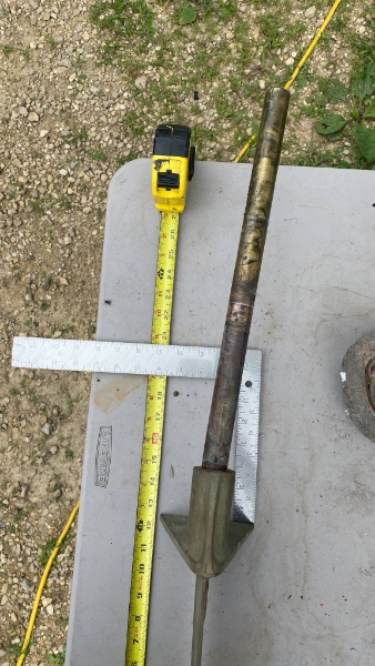

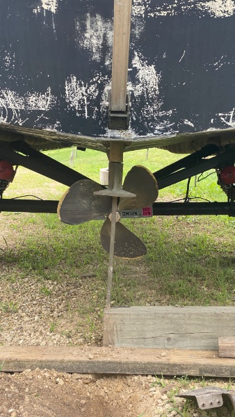

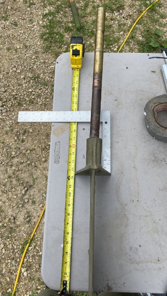

I was able to remove the rudder (had to dig a little hole in the gravel...lol) and with the help of a shop press, straighten it out to the point where it should be good to go. Not perfect but I didn't want to crack it further, there is evidence of a tiny crack starting near where the shaft (bronze on this one) and rudder meet. I will send the rudder and prop out for repair after she is laid up for the winter.
