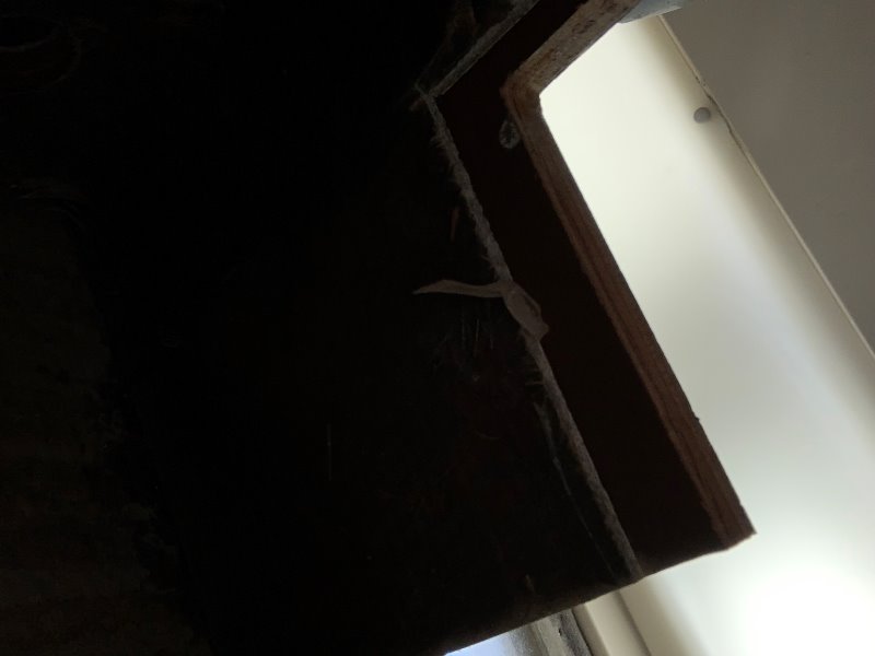

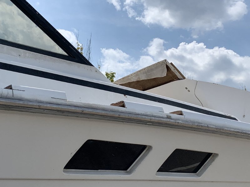

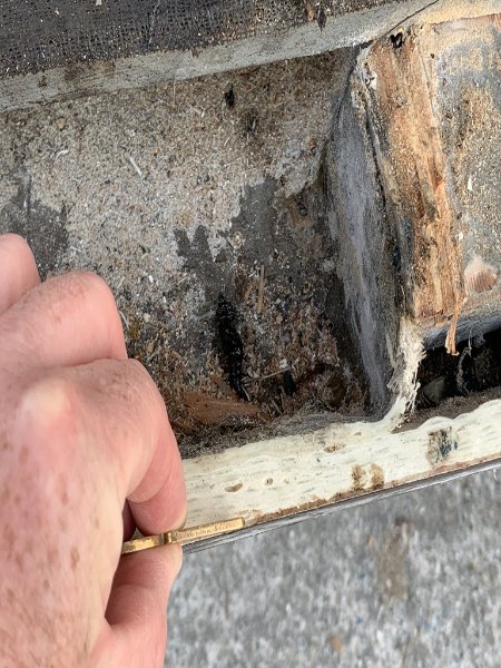

Railings were cut off the boat by sawz-alling around the stanchion bases. You can get an idea of the toe rail coring / glassing from this shot. Those of you with an existing Trojan "SLING" sticker can get an idea of plywood core vs glass thickness.

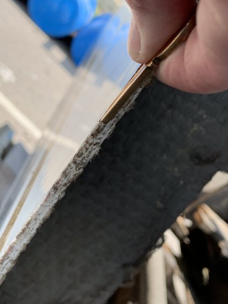

This shot is of the hull side near the chine, and likely a sign of bottom thickness. Took this shot facing straight down on a section of hull side where it was cut off maybe 4" from the actual chine. My guesstimate is its about 9/32 - more than a quarter inch. SOLID GLASS.

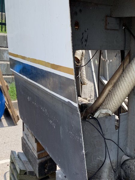

This shows where that last shot was taken from ... if you count from the right, this was the 4th section... 5 sections show in this shot.

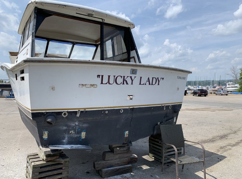

Not sure what he was cutting out, but this is the location that sample was taken from (low on the transom, center line, near where most F32 swim platforms would have been). Note, she was NOT a 'Luck Lady'...

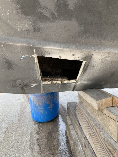

Originally I thought he cut out the forward through-hull /drain plug, but this pic shows clearly not. Don't know why he cut that hole, but you can get a sense of hull thickness forward. That's probably pushing 3/8 to 1/2 inch or more. Again, solid glass.

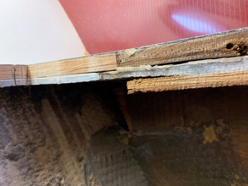

Lancaster most definitely over enginnered a great deal
I became a believer and continue to be every time I cut into something
IMHO that is why the Internationals actual weight may have varied from the published weight
Perhaps Bob Cushman could get a response from John Leed on that item

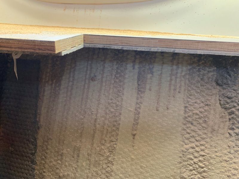

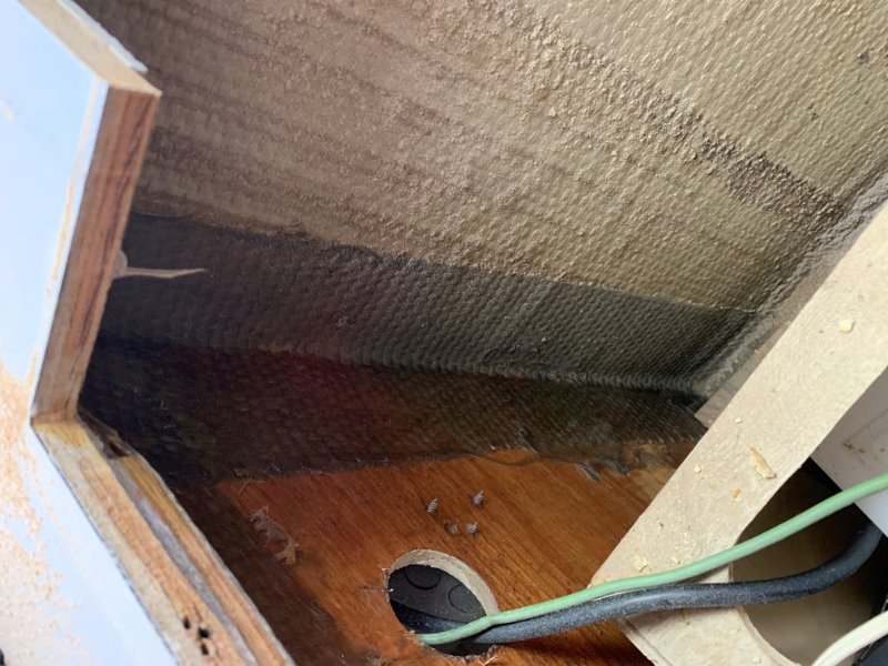

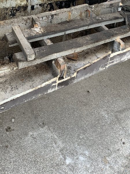

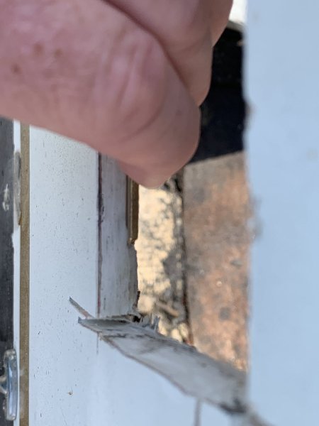

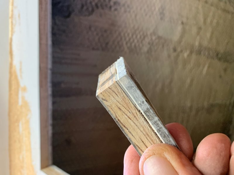

Take a look at the photos below
10 meter Express - galley area
The Schoell design was to strengthen EVERYTHING by tieing it together
look at how the galley is tied to the fiberglass coming off the side in a sandwich
These cuts were done to upgrade the galley sink and stovetop

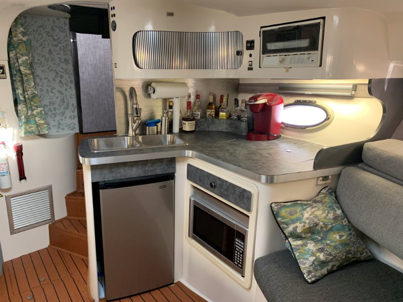

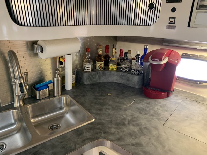

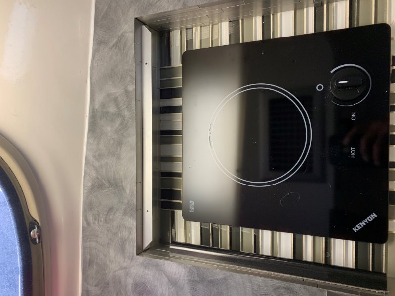

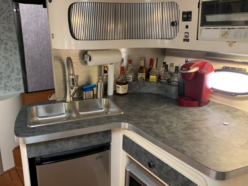

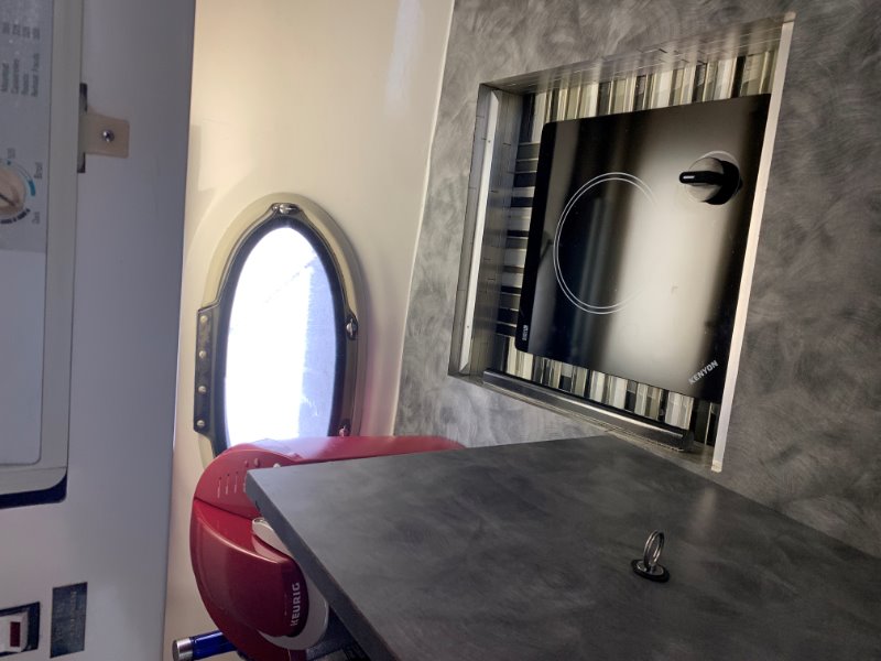

off topic but here's the finished product with new formica, sink & recessed stovetop:
