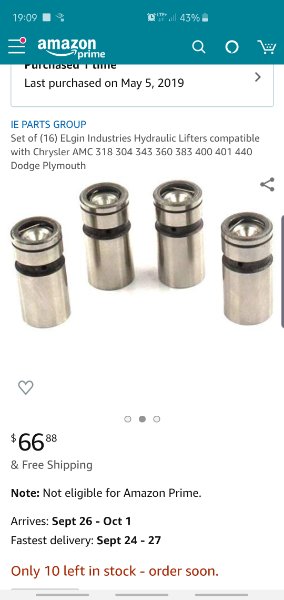

mikeandanne wrote: Fri Sep 20, 2019 7:05 pm
Have you got the part number for the lifters handy ?
The Melling pumps are the ones, M-72 and the M-72HV which I believe you got, you don't really need a high volume pump for an old engine like you have, a standard will work just fine. But you only lost pressure after the lifter change according to your earlier posts, so really the pump was not an issue but could be now if not fitted to the pan correctly. Good luck man, I am out of ideas for now.
HL-2011S

No clue on the quality or fit of the lifters Sealed powers part # is HT 2011 $4.29 at Avance $9.00 amazon . Mike said something about possible over size needed ? I am not mopar guy so not sure .
