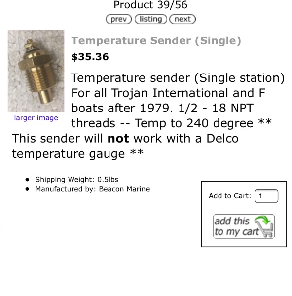

Re: Stewart Warner Guages
Trojan always used 1/2 NPT best to check the size which you can not do with a ruler. take it to a hardware store and check size with female fitting.
