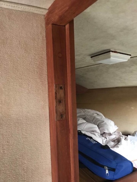

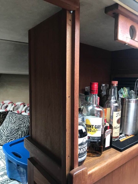

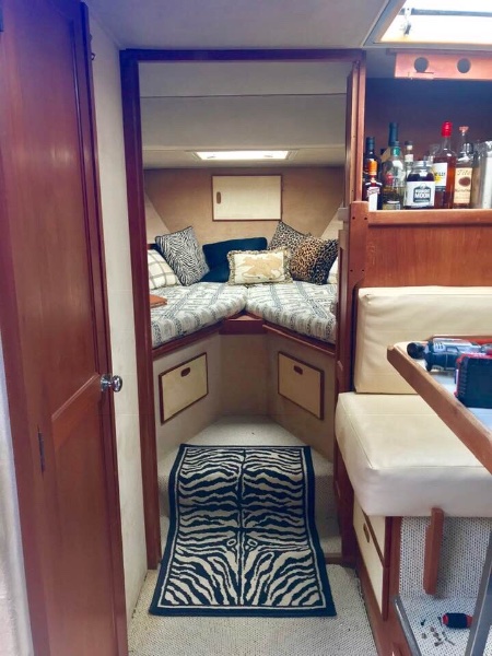

Well I went ahead and removed the door. Getting the starboard wall piece off presented a little more challenge. Those old screws were rather soft and after stripping several I had to make a hardware store detour to get a screw extractor to finish. I am not going to remove the wall piece above the dinette bench as I originally considered as it has become the bar and one must have that on the boat! I also had to change the hinges around to the storage cabinet behind the wall as they originally attached to the removed piece.
Still working on creating some trim pieces to cover the old door hinge frame and a small piece on the right upper section for cosmetics. Matching the wood color will be the trickiest part. Also noticed his site sells the original plugs for the screw holes so might get a bag of those to refill the spots that are now exposed.
All in all though the berth feels SO much more accessible and open. Excuse my mess in the photos. Lots of tools and junk laying around.

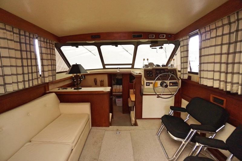

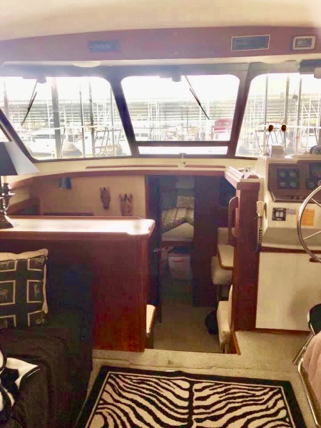

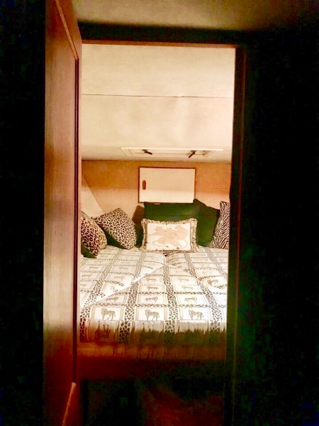

Some before photos

Looks good. My layout never had the door, so the whole stbd side bulkhead is also open (ie not there). So ahead of the dinette I just have a shelf.
Just a FYI - those screws are probably not Phillips heads... they are probably something called Frearson. Looks a lot like Phillips, but the V-shape for the screw driver tip is cut in a different angle than Phillips. https://en.wikipedia.org/wiki/List_of_s ... s#Frearson I don't know how many I stripped before I found out about that and got the right bits. Still pretty soft and strip easily, but at least now I have a better chance of getting them out.
Re: F32 V-berth door removal
+1 on the frearson.You can modify a Philips driver , but it is better to have the real deal.
The stain used by Trojan at the factory for our 78 was min wax red oak, I think the number was 215, yours looks like it might be the same. Looks good.
