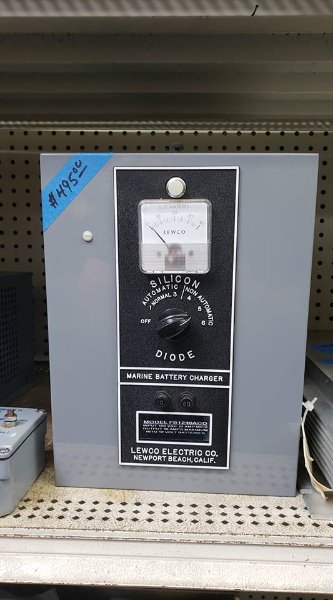

I just picked up a Lewco FS1240ACD 3 - Bank battery charger. Has anyone had one? Currently using one? Or had one? Seems like a good marine charger but I'm looking for everyone's opinion on it.

So this charger works for different battery types and charges in multiple stages depending on the charge the battery needs. It handles three battery banks that can be different types of batteries. Will go down to a maintenance charge when needed. What does a smart charger give me that this doesn't?

This is out of the Manual for the charger. I picked this up for free because I'm on a tight budget this year because of all the repairs needed before spring.
LEWCO BATTERY CHARGER MANUAL…The Full Service (F.S.) model is load-handling
electronically controlled unit.
EFFICIENCY… Due to the extremely high forward-to-back current ratio, silicon rectifiers achieve
rectification efficiencies up to 99% at power frequencies. The high efficiency is characterized by
forward conduction voltage drops of approximately one volt, hence higher output voltages, and
reverse currents of the order of microamperes at the peak inverse voltage.
HERMETICALLY SEALED… Each silicon diode is hermetically sealed. This seal is a great
advantage to the marine field, for the ever present salt air and moisture cannot damage the silicon
diode.
CHARGER CABINETS… The cabinets are power coated.
CHARGING POWER… The charger, without damage to itself can be connected to discharged
banks of batteries and will fully charge them on a perfect taper curve, automatically reducing
charging rate to a trickle as batteries become charged.
INSTALLATION… Designed as a permanent installation in the boat and a permanent connection
to the battery bank.
LINE VOLTAGE... Compensation tap switch incorporated so that the converter may be operated
efficiently from either extremely high or low line voltages.
D. C. AMMETER… Ammeter is incorporated in the output circuit to indicate current being supplied
to batteries and accessories.
TRANSFORMER… The transformers are designed for marine use and incorporate isolated
primary and secondary coils. This prevents electrolysis and eliminates shock on the charging
lines.
