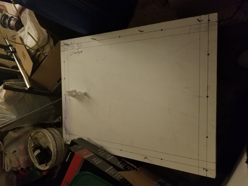

Ok ran into an issue with the water tank. I had to remove the locations where the fill and vent fittings were for the tanks. Replafed the wood top that had entire box of screws in with 3/4 pvc sheeting. And is now centered. Will post pics in a few.

Water tank

How did you figure out which screws were holding the tank in and which were holding it together, or did you just yank 'em all and figure it out later?

I used a sawzall and cut between the wood and tank. once the heads were cut off the tank just lifted out. I used goof off to clean off the goop that was in between the wood and tank. Then went to HD and got 3/4 pvc board. Calked and evenly spaced the SS screws. The tank is back in the boat now
