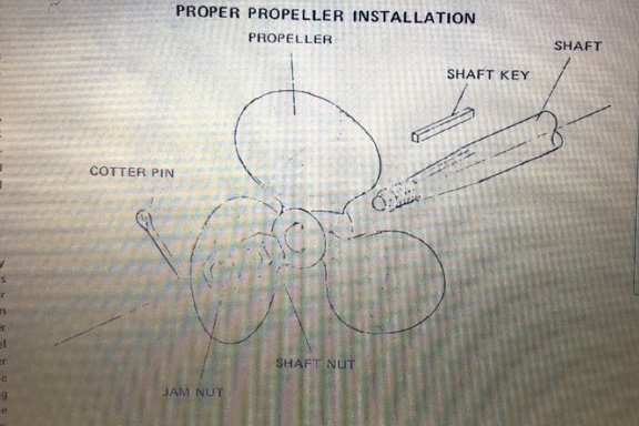

Is the diagram contradicting the instructions? Looks like the thin or jam nut is second nut on shaft in drawing. Maybe I'm misinterpreting these instructions ?

delusional wrote: Mon Nov 26, 2018 7:18 pm Is the diagram contradicting the instructions? Looks like the thin or jam nut is second nut on shaft in drawing. Maybe I'm misinterpreting these instructions ?

Thin nut first is sop . But if you walk around a boat yard you will find about 1/3 to 1/2 on wrong . And if you find a loose prop nut 90% of the time its the starboard side . And the nuts ? its a mix of both ways .
Re: Propeller Installation SPI 32
And WayWeGo is one of those boats that are not installed correctly. She came to us that way and I decided to leave it until the first time the props come off. So far, no issues, but I do check when out of the water and there are cotter pins installed.
