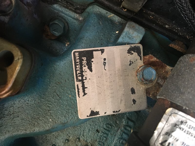

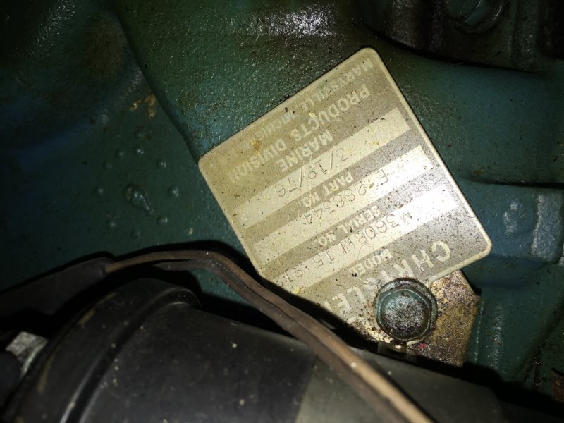

I was under the impression that I had Chrysler 318 Engines. But I was getting pictures of the ID tags on the engine for my insurance agent and this is what they looked like. You may have to zoom in but the numbers are as follows:
M360BWR15 912 & M360BWL15 912.
Does this mean I actually have Chrysler 360s?

Yup, so long as the engines match the tags. Have a look at the side of the block below the heads, there should be a casting number , middle set should say the engine size.
