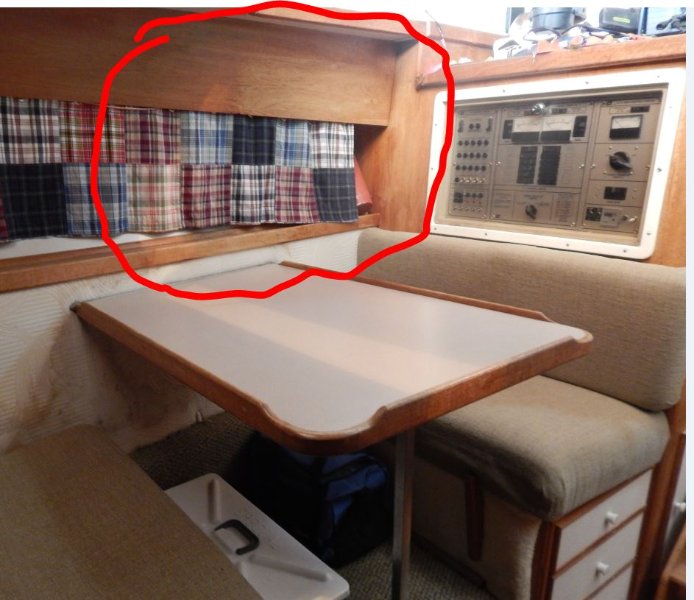

So after 18 years being under a covered slip, and now moored in an open slip, we've discovered a few water leaks where water is dripping from the bulkhead above side windows in the salon in our 1985 F32. We have small holes where previous owner had window blind hardware attached to it the fiberglass. Water is getting into cabin top and finding it's ways down through these small screw holes.

Jamie - Is this the area that you're dealing with?
This was windshield leak, ran through and found its way. ( this is an 88, which by the way is getting the flybridge re-cored this winter)

Thanks for the reply. NO, my leaks are above the salon windows, port and starboard. Windshield is not leaking and I re-bed my seat bases a few years ago so I don't think it's coming from them. The console maybe...the side cover up on the bridge, possible and I will look into that as well.
