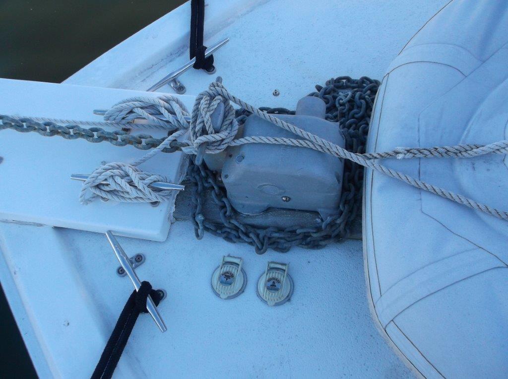

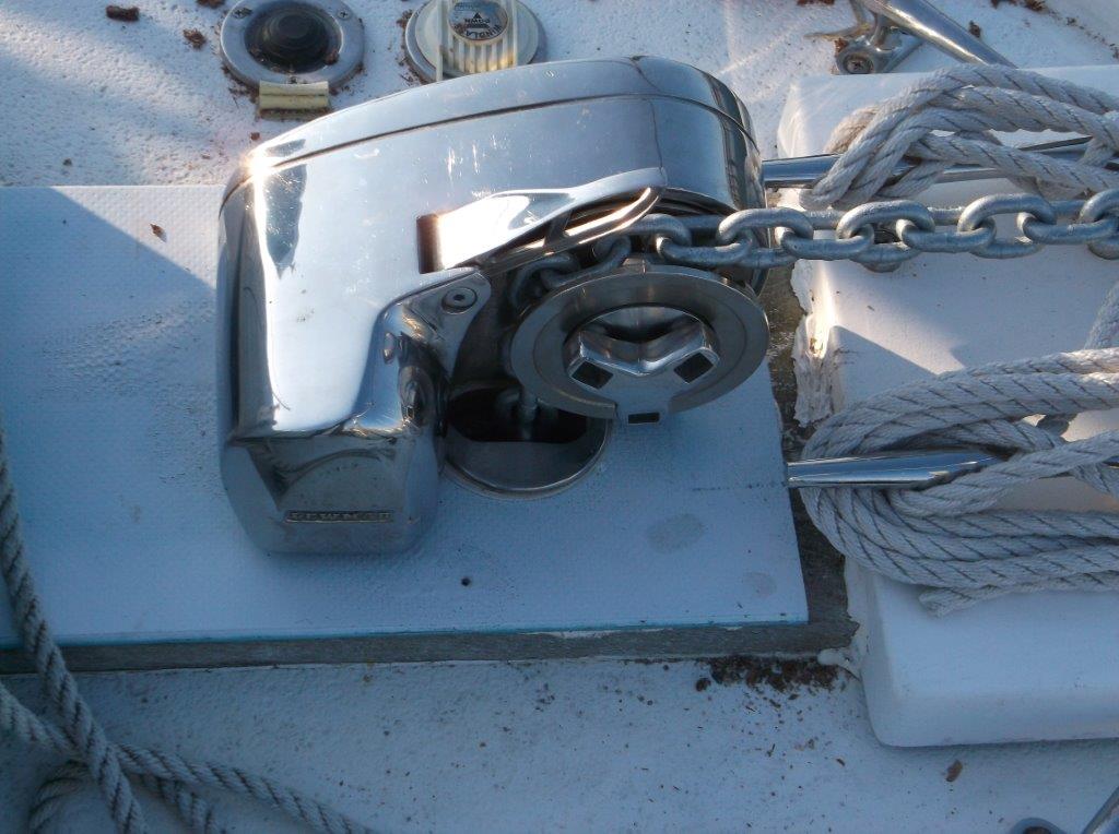

I really like my Lewmar Pro 1000 . I was going to go with the profish 1000 But I got a hell of a deal on the pro (1 year old take off ) and planed on adding the free fall kit . Well the down is so fast I don't see the need for the free fall it faster down then my old good free fall . Now the Good is a great windlass and I would have gone to the F850 chain/rode But the price stopped me . I sold the 40 year old Good CDF for more then I paid for almost new Lewmar pro1000 While a Good is a some what better windlass . The Lewmars are far from junk and look better too .
The reason I changed over was so I could use chain . I use to add a section for over night on the hook . Now it on the rode
