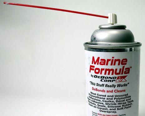

Re: 1975 Trojan F30 tween screw-slow leak into the boat. The leak is coming from where the exhaust pipe exits the boat a
The angel for the Devil.
