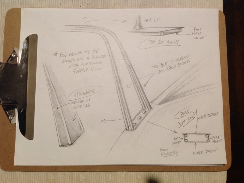

After many hours of deliberation, the decision to go the fiberglass route is out the window.
Never been one much for conformity...so I've completed the designs for an all aluminum arch. Fully skinned without the exposed tubular look seen so much these days.
The arch will be finished in white.

Re: Here we go...Design/ Build Arch
Should be an interesting build, be sure to keep us posted on the progress. Frame and sheet? Welded?
Paul
"Cruise Control" 1978 F-26HT
- Paul - SW Ontario
- Posts: 233
- Joined: Tue Apr 21, 2009 9:33 am
- Location: Woodstock, Ontario
All welded, 2 main hoops & 2 supports per side with 7/8" O.D....welded to 2 slightly curved base plates.Paul wrote:Should be an interesting build, be sure to keep us posted on the progress. Frame and sheet? Welded?
Should give it sufficient lateral stability up to the bends.
Concerted efforts to keep it strong but as light weight as possible.
Sheeting welded to tubing as below...fully enclosing all sides of the arch. (Access holes to the SS base plate bolts, of course)

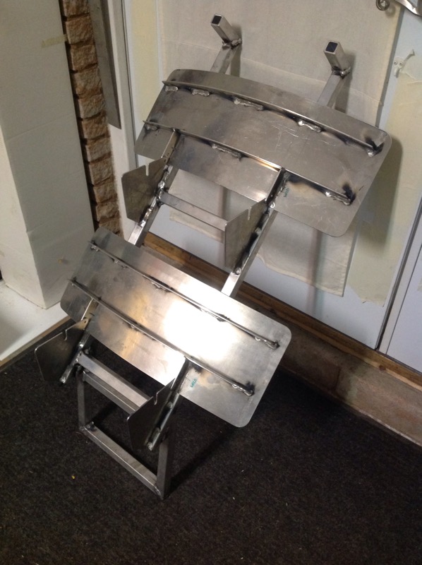

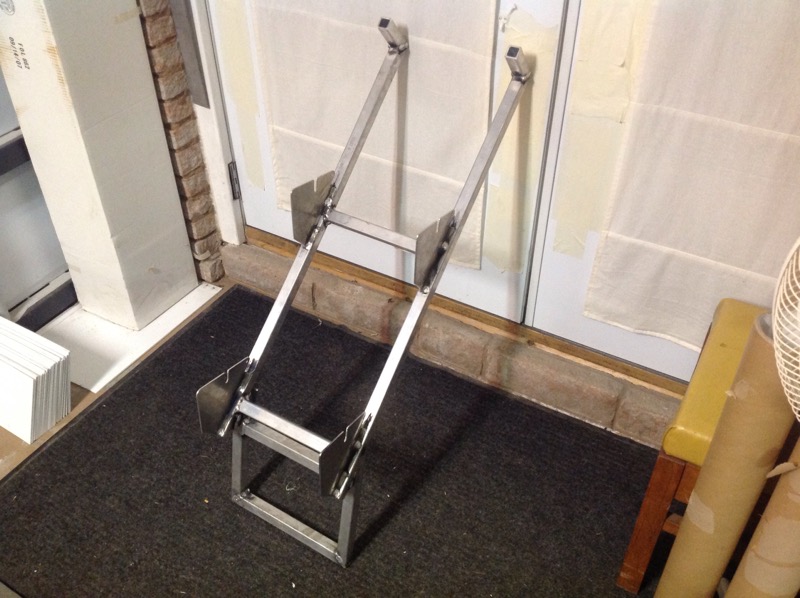

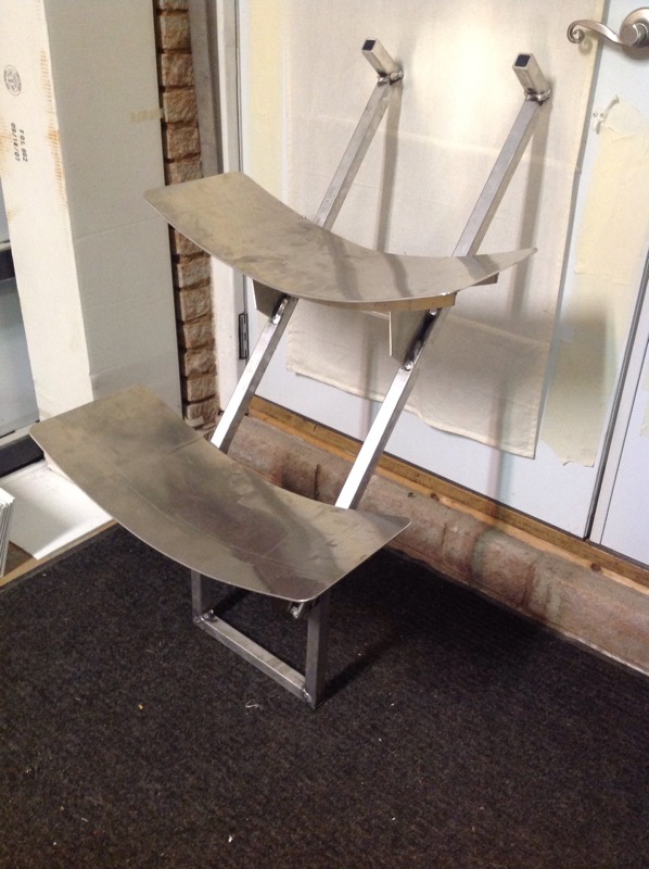

The plan is 0.125 ga. sheets with the only seam being in the centre of the arch both top & bottom.
Yes...it will be powder coated white for the finish. Seen a lot of stuff over the past 10 or so years that has been powdered coated, yielding excellent results.
Designed & built this folding companionway staircase for my Sailboat using 0.125 and it is very strong. No warping problems with this during the welding process, so we'll see with the arch.
