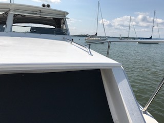

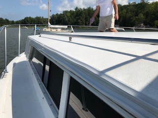

Photos of the install ?
Re: EZE-RV Guttter to Stop window leaks
I will take some tomorrow.
Thanks

Some pictures of install
- IMG_0101.JPG (23.21 KiB) Viewed 12031 times
- IMG_0102.JPG (23.7 KiB) Viewed 12031 times

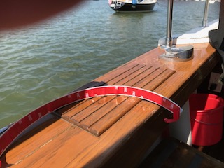

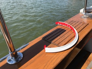

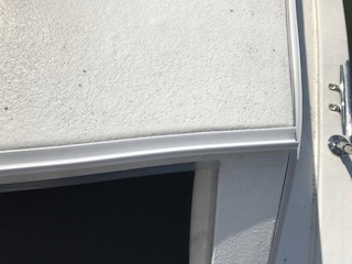

More install pictures
- IMG_0096.JPG (63.82 KiB) Viewed 12031 times
- IMG_0098.JPG (61.01 KiB) Viewed 12031 times
- IMG_0099.JPG (30.37 KiB) Viewed 12031 times
