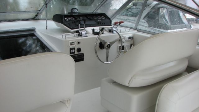

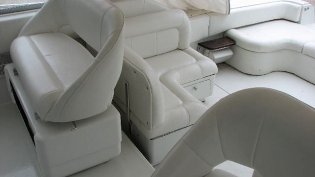

I would like to know how access the fuel tanks better than trying to climb down in the engine room through the center hatch. I did find some portholes to access the fuel tank sending gauges but did not notice if there were hatches back there or additional portholes for the fuel pickup lines/anti siphon valves. I have a knuckleboom crane so I can lift the entire rear cockpit floor out, if it is designed to do so, however I can not find this info on here, so far.

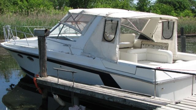

Rob,
Looks like you have a 10m "Mid Cabin" from your pics. That is what I have and the layout is completely different than the similar looking Express model of the same size.
For the tank access, specifically the anti-siphon valves, you need to remove the outer engine hatches. Move the corner bench I see in your pic and (wetbar, add'l bench) on the port side. The anti-siphon valves are right where the fuel lines connect to the tank. You have to sort of lay across the engine to remove it but an easy job and great place to start and work your way back towards the engine for the issue you describe. This was exactly my issue when I first purchased my boat.

From what I see, she looks like a nice vessel! We have friends with a Prestancia 30 and I'm certain you will enjoy the beamy 10 meter compared to the Doral. BobCT knows his mid-cabins! Those outer engine hatches provide great access. The biggest pain is getting the wet bar out of the way (if you have one). If you reach in the storage compartment of the seat and under the wetbar, there should be some bolts that you can unscrew in order to move them.
