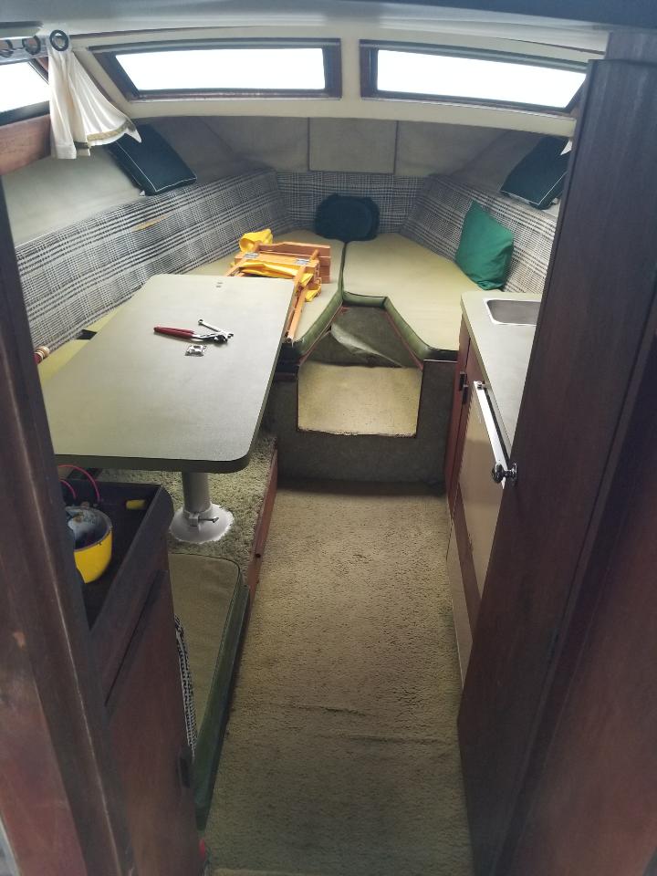

What are you using it for? Because if you aren't looking for a show boat just something to fish from or go out with friends and family there's a bunch of you tube videos showing how to re-caulk the teak floor the rest except that strange cut out under the driver seat? That's not factory I'd make sure it has a backing or braces. It's going to take some serious work but the floor is salvageable.
Yes the 25 does have a table and under the port side v coushion is a storage compartment that should have a cushion in it that goes on the table to convert to a bed if it wasn't pouring rain I would take a few pics of mine so you can see what they looked like originally mine is untouched (it's so tacky i love it)
For the snaps along the windshield I think those are factory you would know if it had the canvas with it, it's very large and bulky I'll bet the previous owner took it home and has it in his basement if you get the boat I would try to track them down see if they will sell it to you they probably fell on hard times and need the money.
That steering wheel of all things was what flew out of the picture and smacked my turn off button it's terrible looking replace it! HAHA
Visually not bad though if it goes for around 1000 or less and you have ample time, space, and project money it would probably be worth it in my oppinion.
Side note insurance values the boat at around 3000 so you need an agreed value policy also just a heads up that will cost a few more bucks every year.

1972 green interior I'm sure they had a name for it but this is everything the filler piece for the v is in the port side storage compartment also btw I just don't need it so it stays away. Also the wallpaper has seen better days in the v and in the bathroom and i did reseal that port window that you can see leaked and stained the back rest. Im too judgmental of my boat its old flaws are natural is what I keep reminding myself.
