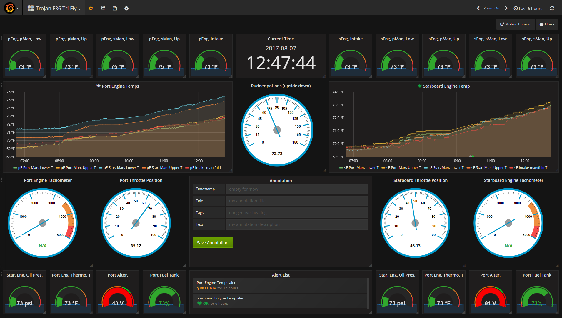

Re: Digital Dash and automation on Trojan F36 tri-fly
Hi Guys,
Just heading to the boat to install the system. Attached is the Dash on my PC. I will send more info once i get it installed on the boat latter today. Ive made lots of progress of the boat and will update the thread with the build process once this part is running.
- 1080p dash all temps real data, test data for RS11
- healthyvessel-f36.png (229.91 KiB) Viewed 22020 times

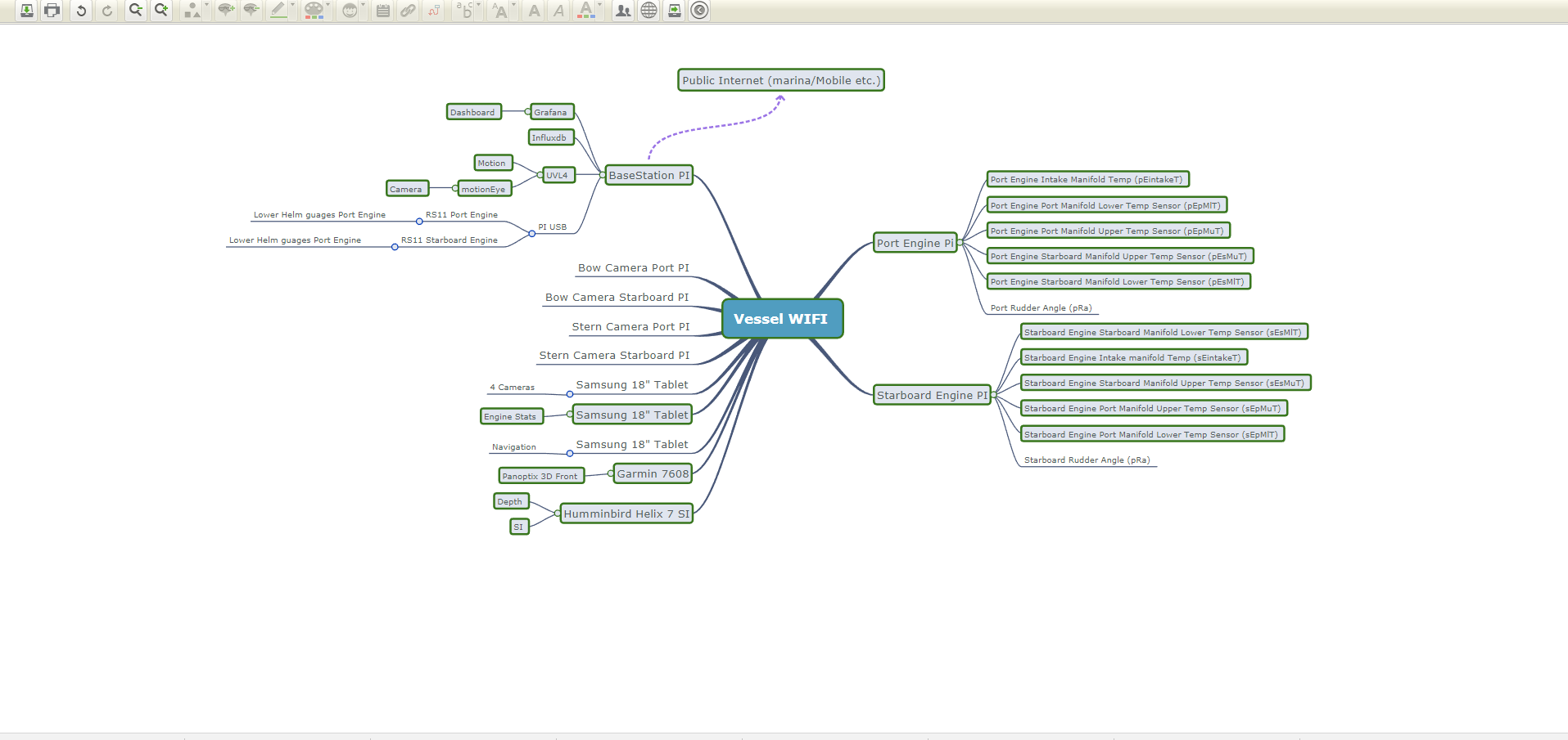

Attached is the overall architecture.
Completed items are in Green.
- completed items in green
- healthyVessel-mm-overview-arch.png (76.04 KiB) Viewed 22015 times
