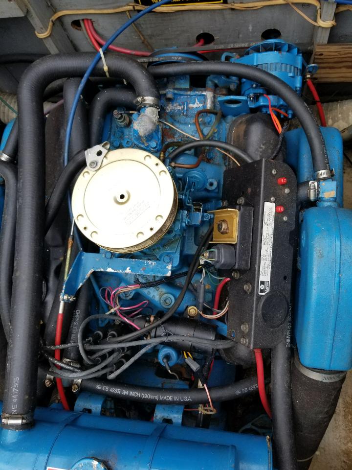

I called to see if Beacon had the correct sender and called my local marina to see if they could take back my sender i may have to buy a new gauge to avoid literally throwing out 42 bucks we will see when they call me back. While i wait here is a picture of the engine hopefully this will help? the alternator issue and tach issue maybe you guys can see something in the picture I missed.

Post a photo not using photobucket , they are charging a large fee to users wanting too post photos

prowlersfish wrote:Post a photo not using photobucket , they are charging a large fee to users wanting too post photos
Sorry I didn't realize it did that I fixed it thank you for the heads up.
