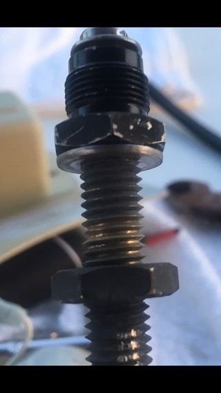

This is the piece I need to get out, I tried to unscrew it but the head snapped off.
If I can unscrew the dummy wiper arm from this, then I might be able to save it.
They give you a new one of these parts with the order of a brand new set up double wiper arms.

Upon a closer look, I didn't realize there was a part of this that spins, I thought that the whole thing was one piece.

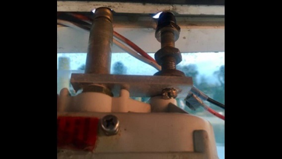

When I got it home last night the motor was frozen. Took off the end cap and tapped out the rust that was in there and it started to turn right away.
There are 4 terminals, G =ground 1=park, 2=turtle 3=rabbit. Park simply turns the motor just enough to get the blade to end up all the way left or all the way to the right. Whomever wired it had it wired to 1, so it would have never turned on anyway. That makes me think that the motor probably doesn't have much use. I might get some extra life out of it.
Given that the 12 Meter dash only has a single push button on/off, I need to pick turtle or rabbit and I'll have to time it just right to get the wiper blade to park where I want it too. Vetus shows a 4 position switch that is needed to operate this motor.

For the 12 meter folks who have the decorative or protective covers, you need to drill weep holes in the covers to let water drain out. The original covers were meant for vertical installations. The weep holes that come with the unit are useless when these are mounted on a 45 degree angle, any water that gets in cannot get out and that is what was at the heart of my issue.
