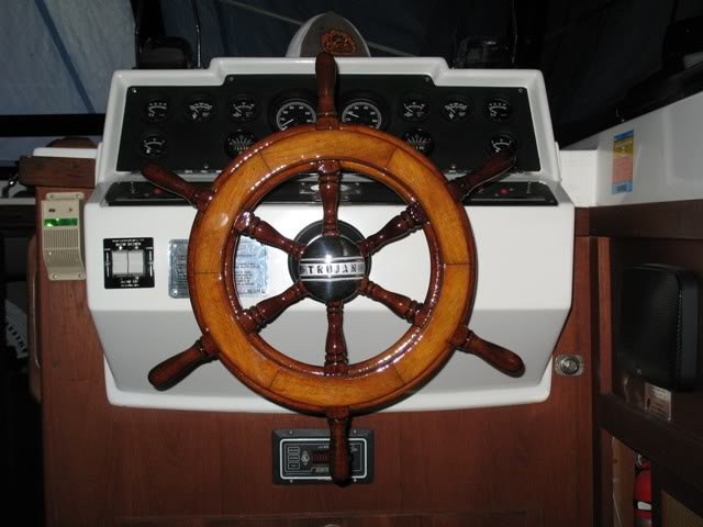

Something like this I assume? This one is off a 1969 28' Trojan Sea Skiff.

I don't care what any body else thinks, but those wheels look a whole lot better then the plain round ss wheel on both of mine, color me green.
