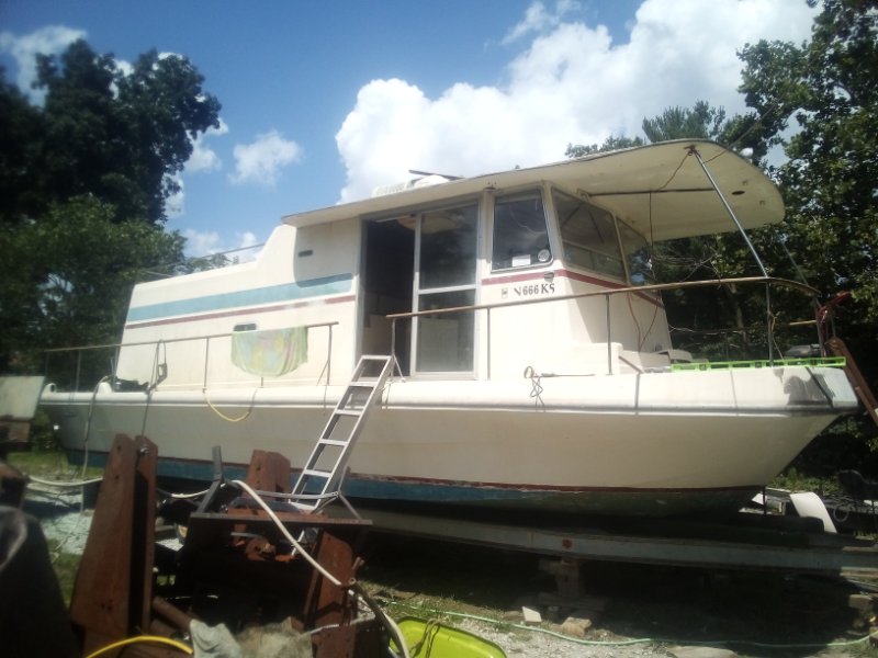

Just got this one givin to me last week she needs some love but it's a cozy Lil boat
- After a day of power spraying
- IMG_20190730_131250.jpg (79.62 KiB) Viewed 25572 times

Survey maybe a good idea btw Congrats

She needs some work but overall a good sound vessel small block Chevy is siezed and the air conditioning unit is bad, but so far all else seems to be in gd working order I did however thanks to this website found the only drain plug (which the original owner hadn't a clue exsisted) in the nose of the boat

What are your plans for her ? Looks like a repower is in order . Looks like its cleaning up pretty good

Go over the sterndrive with a fine toothed comb, repairs on those can get costly. Looks like a older Merc Alpha MR. You want to make sure all is in order there before she is launched or you could be paying for a haul out soon after.
Congrats and good luck with her.

Well my plans are to go thru it and restore it slowly about to pull the small block Chevy out of her this weekend I have a skid steer so pulling the motor should be easy I also got with this a 40ft kyot poontoon houseboat that's been leveled to the deck...just a big barge so I've two projects Ill only keep one but which one is yet to be seen
