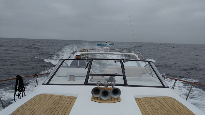

Go the steering all sorted out and drove her down from LA to San Diego. Ran great and all is well.

Glad you got it figured out, also anxious to hear what it was. Sharing problems are 25% of the deal. How you fixed it is the other 75%. I have an 88 11 meter and the steering is vey easy. Love the teak on the deck on yours. 11 meters are great boats. Hope you enjoy as much as we do ours!
