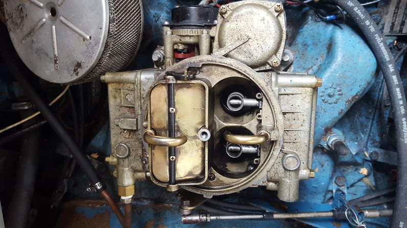

The port with the brass fitting is for the choke heater . If the choke is fully opening you can plug it off . Can you post a photo of the top of the carb ?( with the flame arrester off )

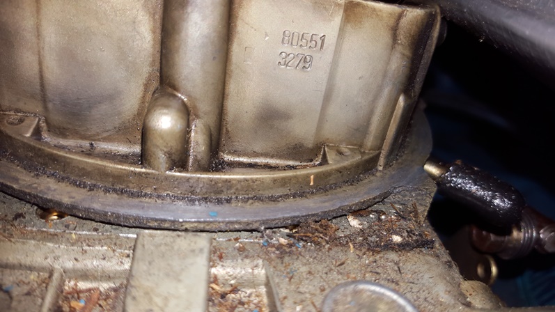

Christian... the 80551 # is the holley model #, checks as a marine carb, vac secondaries 600 cfm.

Thanks Prowlerfish!
At this time, this is the only picture I have. I might be able to go to the boat next weekend to take additional pictures.
"The port with the brass fitting is for the choke heater . If the choke is fully opening you can plug it off . Can you post a photo of the top of the carb ?( with the flame arrester off )" If it does not open completely, what should be done with this fitting?

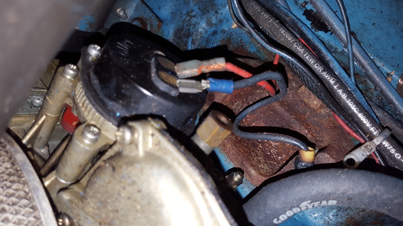

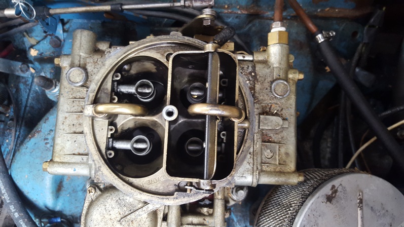

OK. I got some closeups of the carburetor. This first picture is with the engine cold and power on.
Choke On.jpg (170.78 KiB) Viewed 5395 times
This second picture is after a few minute with the engine running.
Choke Off.jpg (156.83 KiB) Viewed 5395 times
It all looks good from that standpoint.

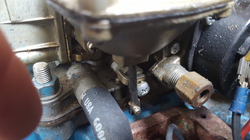

With this said, Can I plug the Heat Tube Port next to the choke?
Open Port.jpg (101.16 KiB) Viewed 5395 times
If I do, I am sure I should re-adjust the idle mixture screws...

Just start the engine and see if there is vacuum at that port, if not the internal passage to the choke is not connected so no worries, leave it alone like it is, they were designed with an open tube into a well to pull heat up, but with the electric on yours appears to work correctly.....is engine idle smooth and solid ( no stalling or sputtering when you put it in gear)??

If you have vacuum I would plug it , but its not a big deal

Thanks guys. Just to be safe I will plug it...
