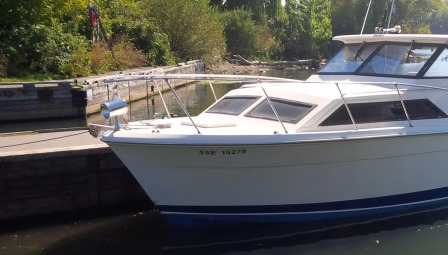

Hello again everyone . On my F25 I have metal holder for anchor lines and would like to change set up . perhaps mahogany or teak pulpit that extends cpl feet out and maybe a windlass . I have access to one for 100 $ so may take him up on offer. To do pulpit properly how far on deck should one go like lets say foot or so towards hatch with wood support from bottom deck or is that over kill ? perhaps people can share pictures from top and bottom of their installations and ideas ?

My idea is to make opening in pulpit and slide that metal holder into it

I guess my pulpit is roughly 50/50 (or maybe 60/40) in terms of over the deck vs over water. See pics in the attached link. For mounting you should be thru-bolted and have some kind of backing plate below (for when someone stands on the very front of the pulpit when you are bounding through waves ... the force on fasteners will be pretty significant). It's a bit hard to see in the pictures, but there is a wooden pad between the pulpit and toe rail, and the forward fasteners go through that. At the aft end there is another (thicker) pad and two bolts through the pulpit/pad and into the rope locker below. This leaves a gap of >1" between the pulpit and deck surface for much of it's 'over the deck' length, so water can flow freely under it and out the forward bow scupper.

Looks great Captainmaniac . yes wondered about backing plate underneath but definitely something along the lines you have yours done.
