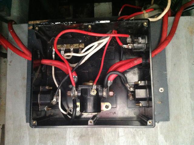

Here is a pic of mine
- IMG_0312.JPG (53.12 KiB) Viewed 6259 times

That saves me from opening the box up. Is that a ground buss the white wires are going to in the box?

Yes and the other Capmaniac was talking about on mine is the trim tabs....MIkeStripermann2 wrote:That saves me from opening the box up. Is that a ground buss the white wires are going to in the box?
Thanks for the info.

Whites are the ground, big reds come from each side + Battery as all Battery grounds are common. A diode exist somewhere that allows the relay to kick in automatically upon starting or upon manually activating the emergency start switch. The other take offs are for accessories such as frig etc.

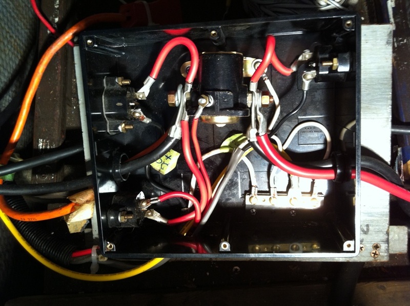

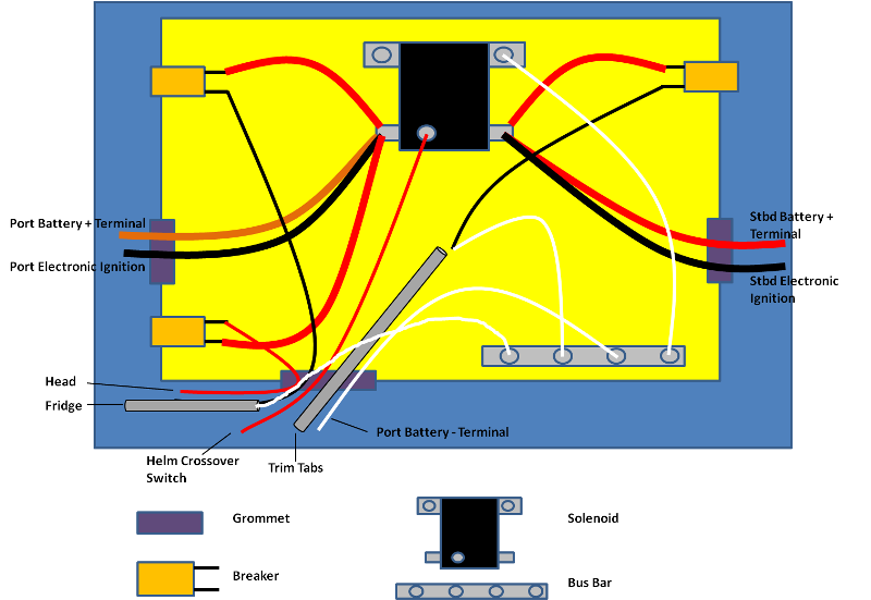

Looks like our wire colours are a bit different, but the connections appear to be the same.
Photo of the box: Wiring 'Diagram':

Remember there is also a diode that automatically crosses the big relay when a switch is moved to start. It is in my 12 volt junction box on the f28. It has three connections to it. Middle one goes to relay activation circuit. Each end goes to one of the ignition start switches. Circuit is power enters one end then out the middle to the crossover relay. At least that is the way mine works.
