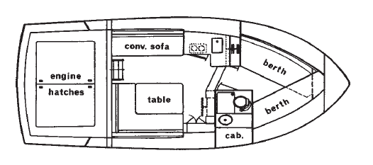

Here is what the factory layout of the F28 Sedan was fro m'76 to '79.
F28 Sedan.PNG (13.65 KiB) Viewed 7454 times
