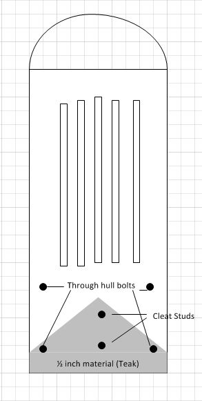

What I am curious about is the bottom side of the pulpit looked like this when I removed it. the thin material in a "T" shape was pretty rotted out. I repaired the rot on the pulpit itself with an epoxy filler and sealed it.
pulpit old.JPG (24.03 KiB) Viewed 4922 times
I think this is a factory spacer? is that a good assumption?
My thought is the shape allows "gunk" to collect in the corners and I would be better off replacing with the same thickness of material in this shape
pulpit new.JPG (31.5 KiB) Viewed 4922 times
Any insight? I know I will create alot more deck contact area, I don't know if that is good or bad.

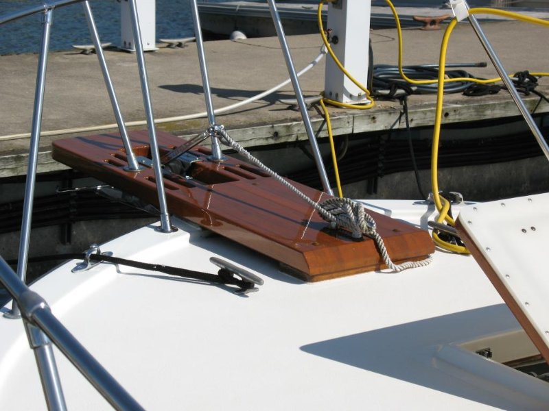

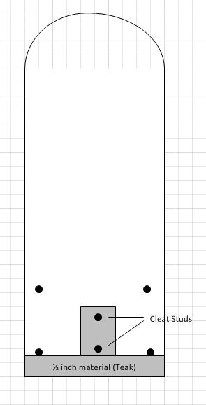

I think the spacers you are talking about were there to 'level' the pulpit (seeing as the toe rail is raised from the deck surface) as well as to lift the pulpit enough to let water / dirt out from under it easily (and eliminate a 'pinch point'). Does the backing plate for the cleat go right to the deck, or is it thinner than the one across the aft end of the pulpit? I thought the underlying block on mine was more than 1/2" thick (the anchor line you see in the second shot is 1/2")
I don't see any reason why your revised design won't work just as well, other than the block may be more visible.

the spacer on mine was pretty much rotted away, so it may have been beveled. the cleat studs and rear bolts went through it. I only have there rear 3" of material, and that was `1/2 in

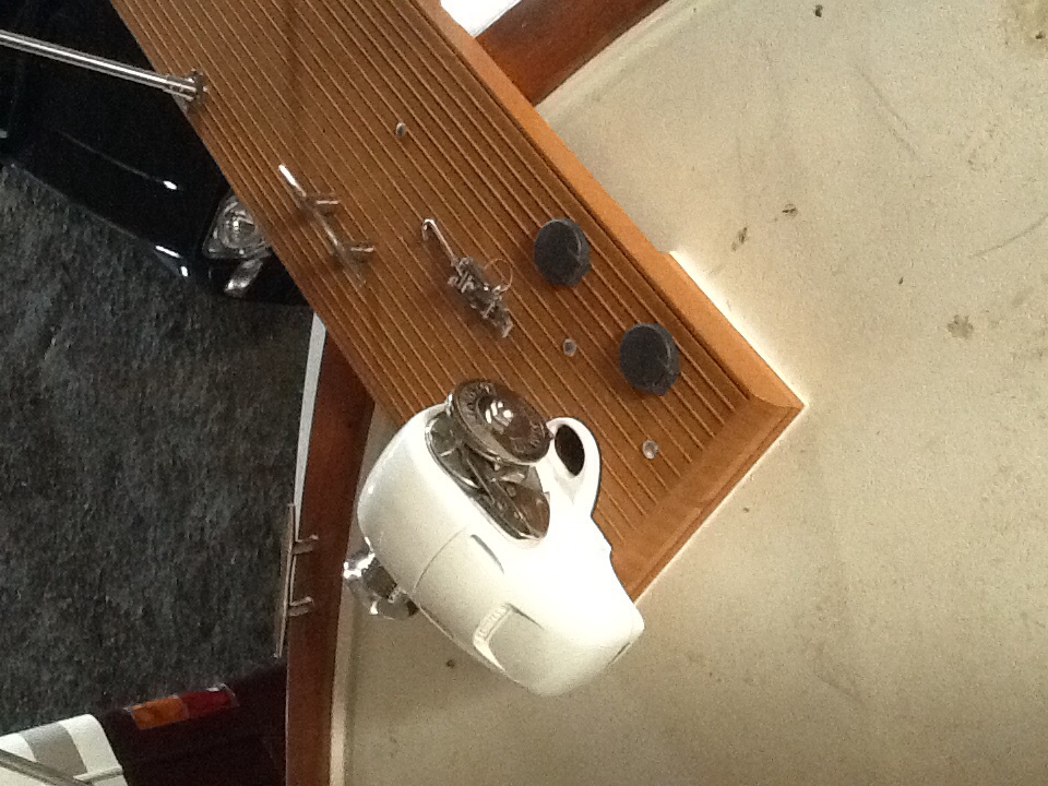

When I added my pulpit, I had a 1" spacer from Seateak and then took a piece of white 1/2" starboard and planed it on an angle to fit the slope of the deck. The 1" did not even reach down to the deck, but I have a teak toe rail that adds about 3/4" height to the fiberglass toe rail. My spacer is about 8" fore and aft in order to get a solid base under my windlass. I will try to attach a photo.

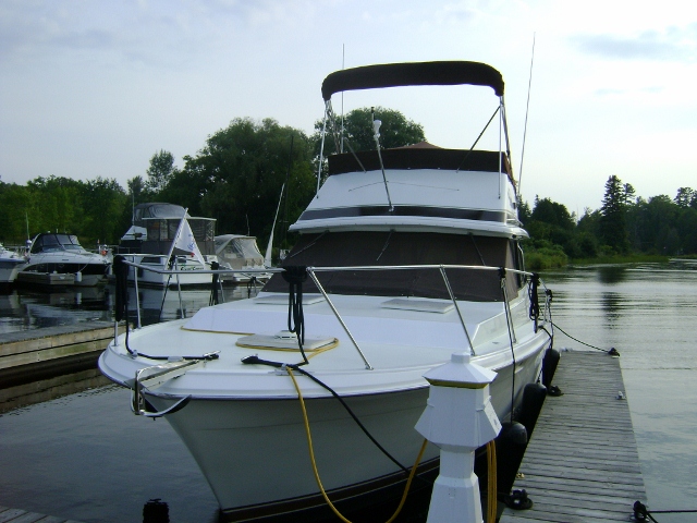

Gitch, what your showing is a pulpit that looks very much the same as mine. I rebuilt mine last winter in the shape and dimensions as to what was on the boat when we bought 3 years ago. It started to rot badly. We do not have teak on the toe rail either. The support for the deck is simply two pieces of plastic composite about 2 inch square under each left and right corner. The same composite is used under the deck to spread the load across a larger area. Wish I had some photos to post.

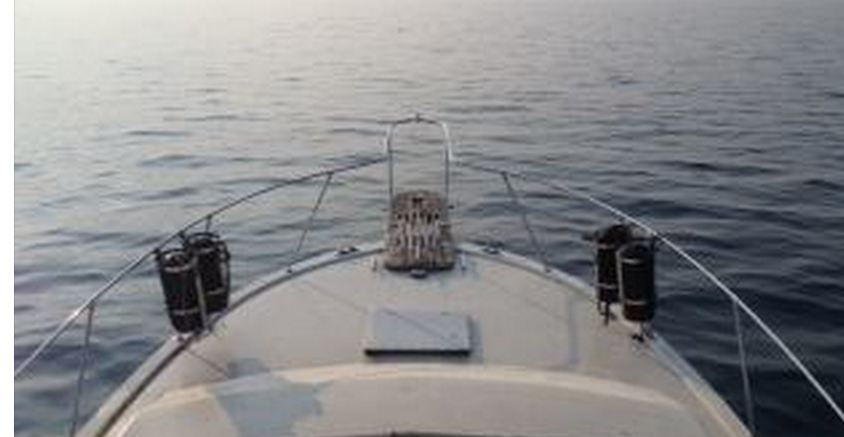

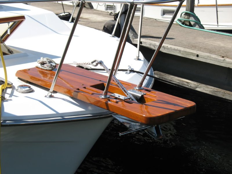

I just thought I would chime in about the anchor pulpit, mine is all steel easy maintenance, easy to sand and a coat of paint, also very strong. Just thought I would put this out there so people know there is another option, I am sure most do, I like the least amount of maintenance possible, and teak is high maintenance but yes it looks great, there is enough teak inside the boat as you all know, I know this not quite on topic but it is an option.
