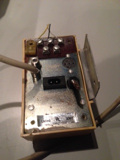

2) I have a remote controlled spotlight to install. I know there was one previously installed so I did some digging last night to find what wiring remains. I ended up finding a dead-end wire so I got side-tracked and chased it for about 40 feet down to the engine room and up to the galley. In one of the galley cabinets I found a mysterious box. It had both AC power and DC power running to it and a couple coaxial cables. Can anyone identify this for me? Couldn't find a mfg or part number anywhere on it. Picture is below.

#1) That should be fine .
#2) I don't have clue . A wild guess would be some kind of tv antenna booster or control
can you post more pics of the front ? Where do the wires go ?

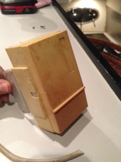

A TV antenna booster seems like a reasonable guess. It had both AC and DC power wired to it. Two coaxial type wires coming out of it were just bundled up next to the box. One ran all the way up to the flybridge (antenna wire perhaps?). The DC power was wired directly to the battery so this wasn't an original factory install. Picture of the front is below.

I agree with Paul, looks like a TV antenna controller. From the looks of the multi-pin socket, it may have been a directional unit that could adjust/point remotely for better signal acquisition. Is my age showing?

Yep both Bid D and Paul are correct. I still have one of them on my boat. But, I'm not as old as them...put together! LOLBig D wrote:I agree with Paul, looks like a TV antenna controller. From the looks of the multi-pin socket, it may have been a directional unit that could adjust/point remotely for better signal acquisition. Is my age showing?
