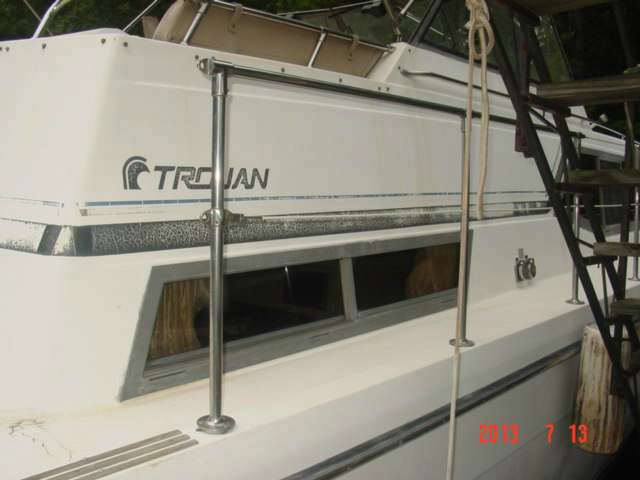

I'm looking at purchasing a 87 Trojan tricabin 36'. It needs tones of restorations but my main hang up is the starboard side gunnel or walking area is soft about 6-8' forward from the aft.
I have read that it is Very easy to access under the area but of course fiberglass sing is not easy but at least it's supposedly accessible.
I haven't seen how to get access and I am wondering if it's worth looking deeper to decide if I want it.
Do any of you have experience with this issue on the tri cabin?
You can see in this pic where the water got in where the fiberglass is cracked.
I need advice.
I need advice.

The access under that area is pretty reasonable. By that I mean that there are no mechanical systems or tabbed-in bulkheads (OK -- there is 1) that would really get in the way, mostly just the soft goods that cover the ceiling, and panels which unscrew. Of course, once you BUY IT, then open it up, you are stuck removing all of the rot no matter where it takes you, which may be far from where it looks like it is right now. And once you start, you have to finish, because the only thing worse than a boat for sale that is in need of repairs is a boat for sale that has incomplete repairs.
You should also ask yourself why the deck is wet. I suspect the windows. There is no point fixing the deck and not addressing the cause. Did you put a moisture meter on the cabin side below the window? Does it read off the scale? What about the opposite side deck? Did you tap everything out with a small hammer or screwdriver handle to look for areas of delamination elsewhere?
If the boat needs "tons of restoration", I would ask you why bother? Do you want to go boating, or do you want to work on a boat? I enjoy each, but the "work on" part has never been so bad that it interfered with the "go boating" part. It always cost more money and takes longer than you think it will to restore something, and your best maintenance dollars are spent finding defects in a boat that is not yet yours. Think long and hard if you've never undertaken such an endeavor. On the other hand, I love my tricabin to death. If you decide to go forward, you may want to check out this place http://minicraft.com/colormatch.htm I've never used them, but I've heard good stuff.
Two questions for you: How many other tricabs have you looked at? Why do you want this particular one?
I'll share something with you. I looked at ten 1981 to 1985 tricabins before I bought the 11th one that I looked at. Good luck whatever you decide. And please keep us posted.

Don't consider repairing from the underside...... you are working in a restricted area and gravity is against you.
Why not consider the obvious... repair from the top. You shouldn't worry about cutting the old deck finish, replacing with a new finish is always best as you get a tight seal to the replaced core.
As said previously there are many boats for sale out there that do not require a project to get them going.
NOTE: the lower the initial price the greater the $$ put in after purchase! That is my view and experience.

I've been working on a deck repair on my F-26, here's the link to the thread with some photos I have of it. http://www.trojanboatsforum.net/wforum/viewt ... f=1&t=7235
Some things that I learned while undertaking this project.
-None of my cleats showed any signs of having any type of bedding, whether it was butyl tape or caulking, there was nothing.
-Some of my bow rail stanchions had been caulked, it seemed liked some of them were skipped, which is kind of odd.
-the original gas filler neck had no caulking.
All of the above contributed to my deck core getting saturated and needing to be replaced.
-When I started, we had thought we had only two areas that were soft, when in fact I ended up replacing all of the original balsa coring on the main deck with new foam coring. Once we opened it up I was amazed at how deteriorated the original core was, and it ended up being a much larger project than anticipated. The cabin top need some core replaced, but not all of it.
I do agree with Ready123, that it's better to repair it from the top.
Have you checked the deck with a moisture meter? Before I started, I had mine checked with a moisture meter showed mine to be mostly wet. If it shows a larger area being wet, more than likely there is further unseen damage.
If you really like the boat, and are pursuing it I would have a surveyor look at it. It wouldn't scare me, but more than likely there will be more expense in repairing it than expected.

Wow!, Your tri cabin is what I would imagine I would want to make of the one I'm looking at.
He WAS asking $22k, now $17k. It's not worth that. It's really only worth around $10k to me if the rot isn't too bad.
I have seen it in person. It is originally from Baltimore, MD and was stored in a outside slip. All the windows have leaked and it's obvious in the interior with water stains on the fabric and teak. It has never been updated AT ALL... It needs full upgrading. I didn't go into full inspection mode because after I noticed the soft decking I got scared and left soon after.
He has text me, now, 3 months later to see if I'm still interested. My inner thought is that he has absolutely no luck with selling it and will probably come off his price tremendously. This is not his personal boat. He is a auction buyer and got this one that way, so he probably has very little in it and he said his wife is on him to sell it when I first met him. If the rot is not bad I would consider trading my Carver even for it and he could sell my Carver pretty fast since it is well maintained. BUT if the rot is more than I am thinking then it's not worth my effort and $$$
You can check it out here. It has twin 5.7L with a 6.5k ONAN of which I am grossly familiar with from my former Trojan F44. I have a love hate relationship with Onan.
After looking at the pics what do you guys think?
Here are the LARGE cracked areas in the fiberglass
This one here is the one I think that really let the water in under the fiberglass

QUESTION: On that Gunnel or side walk way, how is it made? Is it mostly fiberglass with a center runner of Plywood down the center for core support or does the wood run down into the hull or what? If it's a simple blank of wood cored inside the fiberglass? I don't see that being difficult to re-core and refiberglass.
If there is a lot of wood wrapped around this, that and the other, wrapped in fiberglass, then there is a TON of work that might detour me even more.
If it's a simple board running down the side then that is easy to fix. I can do fiberglass etc.... I'm worried more about having to cut a LOT of glass off and then fixing more than the walk way.
Anyone have any idea's what's all inside the fiberglass? What am I looking at here?

Re: Soft starboard deck on a 87 Tricabin need advice
Mine is an F-26, but it was constructed very similar to the photo that Ready123 posted of his F-32, and probably similar to the Tri-cab. The photo below is of my port side walk way. It was 1" thick in total. The top layer with non-skid was 1/4" glass, 1/2" Balsa core, which was replaced with foam core, and the bottom layer is 1/4" glass. The toe rail is cored with plywood, as is the base of the cabin top below my side framed windows. The F-26 has a solid fiberglass hull, I believe most of the F series boats were built that way. This walk way section actually went together pretty quick compared to the rest of the projectjwrape wrote:QUESTION: On that Gunnel or side walk way, how is it made? Is it mostly fiberglass with a center runner of Plywood down the center for core support or does the wood run down into the hull or what? If it's a simple blank of wood cored inside the fiberglass? I don't see that being difficult to re-core and refiberglass.
Thanks for the info. That makes me feel better about the soft deck. That looks much easier than what I was originally thinking. Is the foam core better? I would assume it doesn't absorb the water like wood or Balsa... Is it more expensive? Where do you find it?
