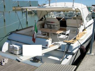

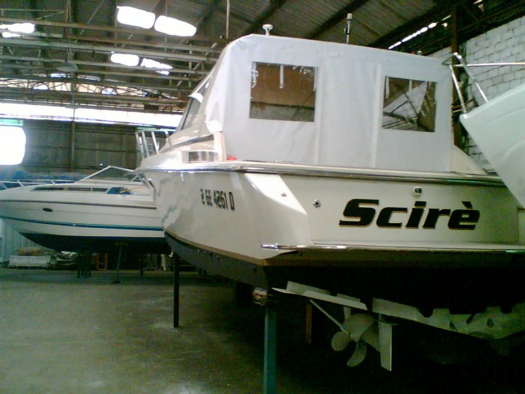

Re: repowering 34 Sport Express

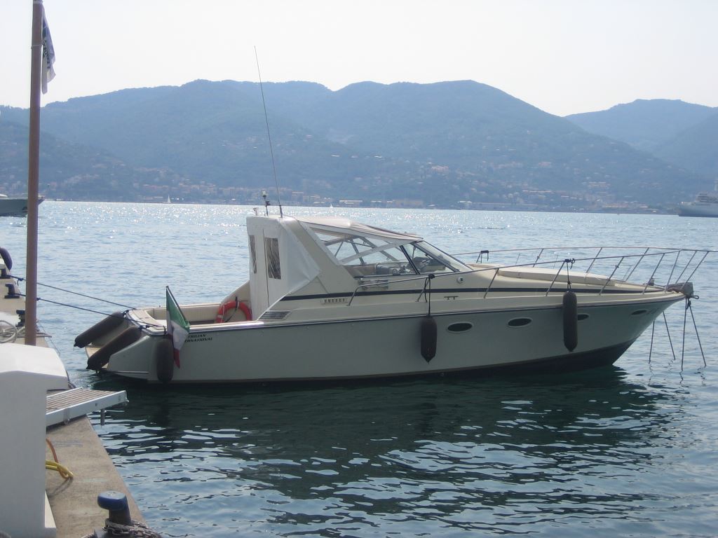

Some photos.
May be it's the boat you call 10 meters. It was build in 1990 when the factory was named Bertram-Trojan (this name appears in all docs I have).
Alberto
that is indeed a 10 meter.

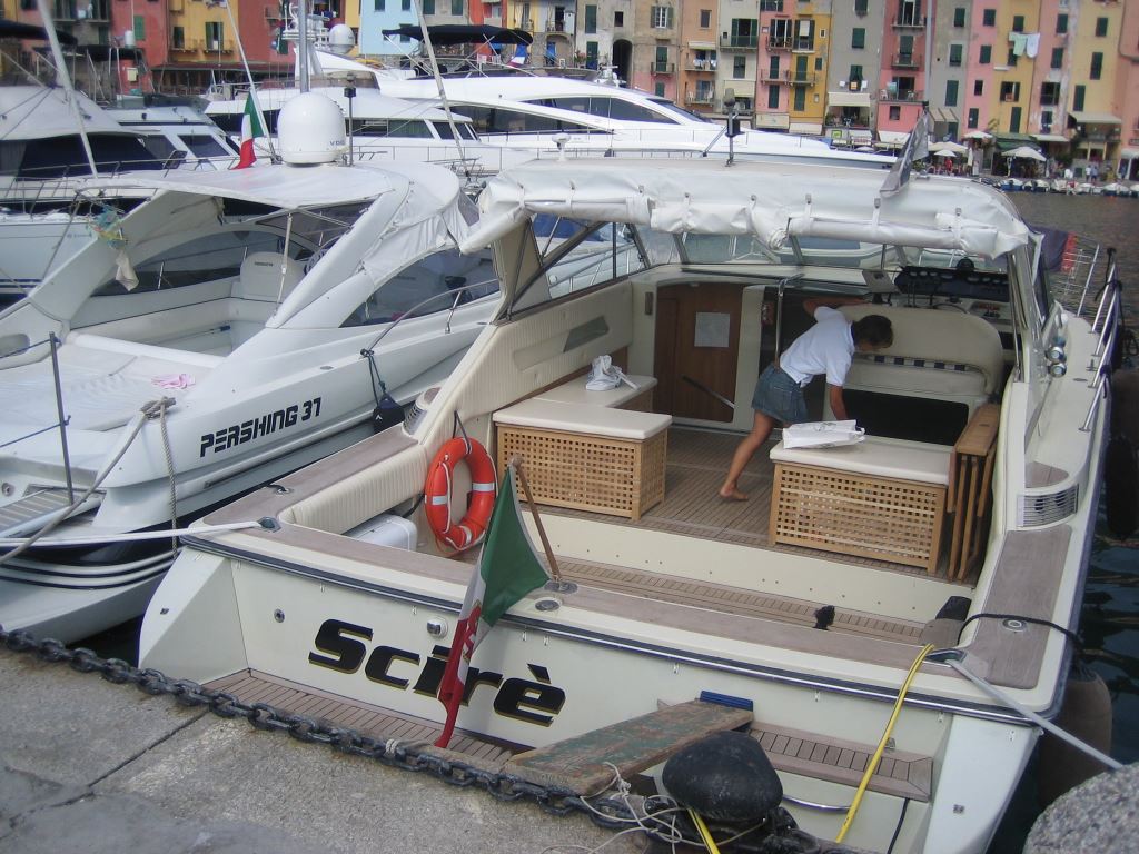

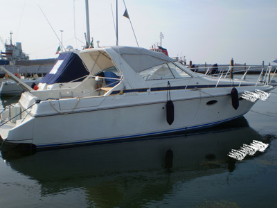

These photos I am posting below might actually be your boat...
second photo attempt
Both are in Italy, however after further examination they are NOT the same boat.
One has a mid cabin style of transom, the other does not.
- Foto(205).jpg (104.61 KiB) Viewed 8331 times
- IMG_1096.JPG (103.77 KiB) Viewed 8331 times
- IMG_1217.JPG (152.97 KiB) Viewed 8331 times
Interesting note...the Pershing 31, which is parked next to the 10 meter was designed by the same guy who designed the 10.8 Meter Express.

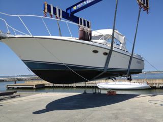

It's the same boat but there are some little differences. This is normal I think.
Some more photo. As you can see interiors was completely redone in cherry wood.
