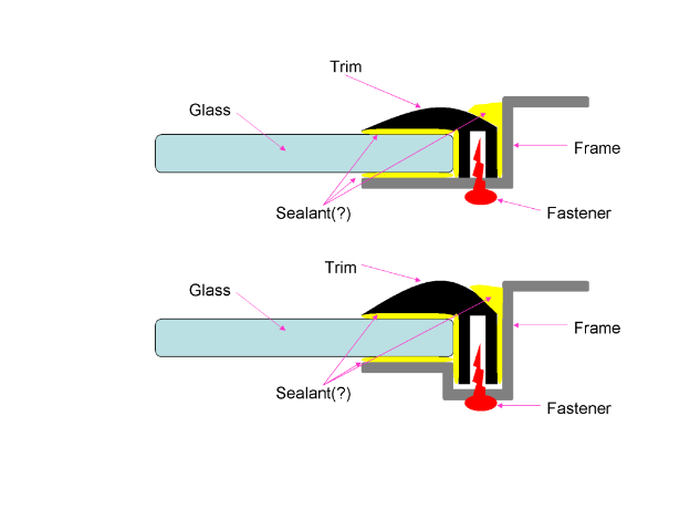

Here is a thread from a while back re replacing one panel on my '79 F32.
viewtopic.php?f=1&t=1042&hilit=window+window+trim
And here is the diagram I referred to. Not sure if the frame is flush (top pic) or recessed (bottom pic).

Great diagrams! Does anyone have anything similar for the front window of an F26? I need to reseal my front window this Winter.

Thanks, that is a great diagram!!! I will compare it to what I see on my boat this week. It doesn't look like a difficult job, just time consuming.

Dog : I would expect there aren't any real differences between how Trojan did it between models, but between '71 and '79... not sure.
Bars : I hired a guy to deal with it for me(worked out to my advantage - he got the trim off without damage, got the old glass out, had a piece of replacement glass cut, slipped during the installation and cracked it, and had to get another piece made...). He went to a glass shop and told them what he was trying to, they sold him a special tool to deal with cutting out or through the caulking in this configuration. Think it cost him about $50.
