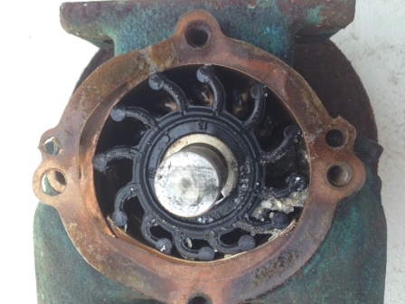

The river I boat in is only about 4 feet deep in most spots. The channel is around 10 feet deep but if you venture out of it at all you are liable to encounter some shallows. So while leaving a nice beach spot on Saturday I sucked some sand up into the port engine raw water intake. The engine temp started shooting up so I shut it down and motored home on just the starboard engine. When I pulled the raw water pump to inspect I immediately discovered what had happened.

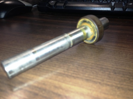

I noticed the pump was leaking from the bearing/hub side so I figured the seal was destroyed as well. Found the pump was pretty much clogged with sand. With the pump apart I found the bearing was also clogged with sand and had started corroding from the saltwater getting past the seal.

Water pump rebuilt and ready for installation. Replaced the bearing ($14) and seal assembly ($25). Also faced off the cover plate because it had a pretty deep wear groove in it. New coat of paint and it's ready to go!
