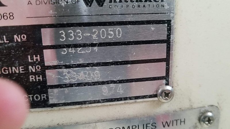

Can you get me the numbers of your ID plate? It will be under helm in the doors to the pannel I will find what Trojan put in it new. Only 2.0 gears are listed for the express , but if there was something odd on a boat it will be on the paperwork. I will get Bob/John to check it when I get your numbers.
ID plate looks like this

Re: 10M Express what is the best prop?
Posted: Thu May 06, 2021 8:35 pm
by Trojan10m
Hull No. 333-2050
LH: 34257
RH: 33409
Inspector: 974
Thank you.
Posted: Thu May 06, 2021 11:22 pm
Trojan10m wrote: Thu May 06, 2021 8:35 pm Hull No. 333-2050
LH: 34257
RH: 33409
Inspector: 974
Thank you.
I sent it to Bob and John, But are you sure about the 333 (Hull No. 333-2050 ) ?
