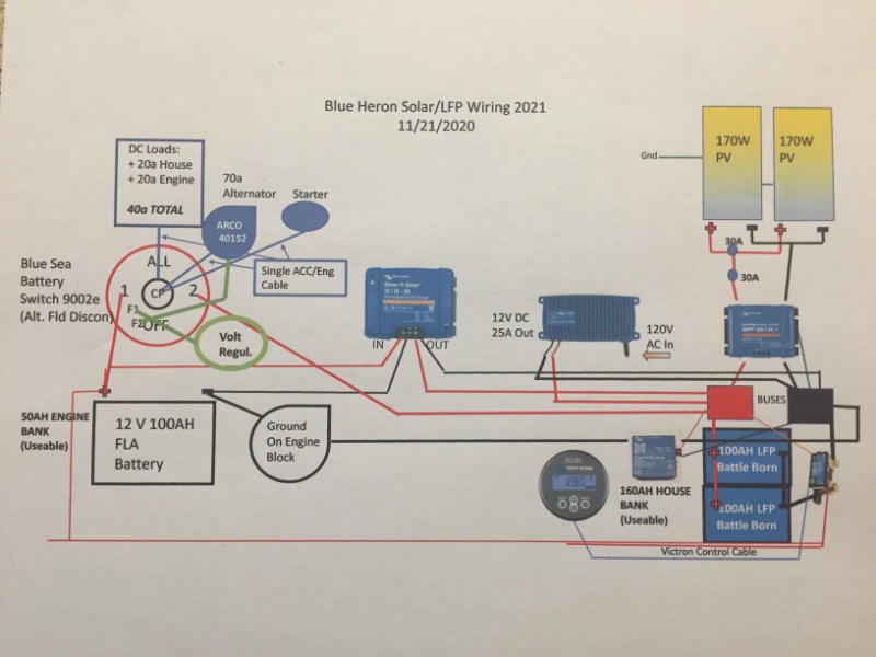

OK. I’ve decided to add the LFP house bank to my little old F26 HT. The ABYC had a good online seminar about LFP on boats. That dumped me over the edge. Yes, it’s going to be expensive, and yes, I can afford it, and yes, I’m getting too old to know better....BUT, it makes sense to me, as I like to get off the dock and be self-sufficient without gennys.
Here’s the “almost final” schematic showing actual components I’m using. I installed the solar panels and controller his year and will be installing the LFP and components for house bank once the sun shines here in upstate NY. After spending a lot of time researching and getting information from supplier support contacts, as well as the ABYC I’ve confident I’m making the right decision.
I’m still on the fence about incorporating the ACR between the 2 battery banks. It’s an older model that allows me to set the combine/isolate voltages between the LFP and FLA batteries. I’m waiting to hear from my supplier contact about what I should do. Notice that I’m not charging the FLA except with the alternator. The DC/DC charger will keep the alternator in check when underway. Biggest issue I’ve found with LFP is their charging profile off a “dumb” alternator, like I have, but the built in BMS (Battery Management System) in good LFPs prohibits under/over voltage issues.
I’m 76, in great health (knock wood) and plan on the new system outliving me, and my kids sending me off to a flaming Viking funeral (not because of thermal runaway of the LFPs, I hope!). So, bottom line, I’m not making an issue about cost/long-term return.
Happy Thanksgiving to all!

by paskyhawk
I'm probably missing it but what keeps the engine battery bank from being overcharged while the alternator is sending power to the rest of the system. Do you have to do anything special with the drive belts and pulleys with the extra load.

Looks like a nice set up .
As far as over charging the starting battery looks like voltage reg is still using starting battery voltage .
