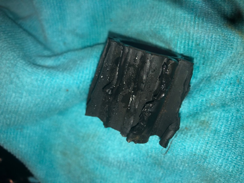

Raw water pump impeller was in very bad shape new impeller and all is well.

Glad its ok . Did you fid out why the impeller burned up ? I assume it was new as the pump was rebuilt .

The impellers were the first thing I replaced two years ago when I bought the boat. After working on it all this time running to check whether the latest repair solved the problem, and to maneuver in the marina at launch and haul-out with plugged exhaust elbows it burned up. I always shut it down when the temp exceeded 180.
I never went back to the pump because I already rebuilt it. I guess the moral is, if your overheating problem requires lots of repairs and leads to a complete blockage and no flow out the exhaust, recheck the impeller. I luckily found a used one left by PO that was still useable so I could finish winterizing
