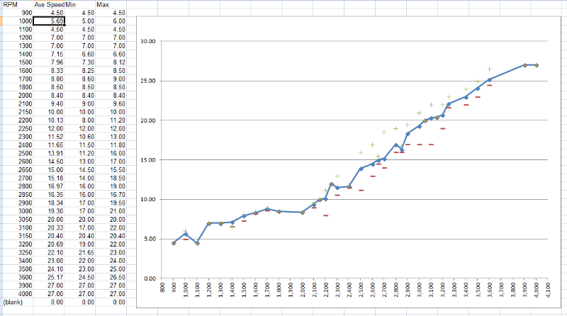

I have 360s instead of 318s, so don't know how similar a speed curve you will see. Posting this anyways just in case it helps.
This is what I get - speeds are averages at that RPM over the past 20 years I have owned the boat (yes, I keep a Log, call me old school). The + / - show the Max / Min speeds I have seen at that RPM. Obviously things vary based on load, wind direction and strength, and sea conditions. Engines are probably a bit more tired today than they were in 2000 but not a huge difference in performance.
1500RPM is a good speed for me for displacement cruising. Around 8 knots.
The next sweet spot is 2800-3200 RPM. The boat is well up on plane, leveled out (with assist from the trim tabs), and the secondaries on the carbs haven't opened up yet so a lot less thirsty for fuel. I can cruse in this range (conditions permitting of course), for hours. I have done Hamilton to Cobourg, following shoreline and not just straight line route, in this RPM range multiple times - 5 hours+.
I have pushed it to 4000 / 4100 RPM but no more than 3-4 times since owning the boat, and for no more than a couple of minutes, just to see what it would do. Usually if I am running over 3200 RPM, its a case of "I really don't want to miss this bridge lift or we have to deal with this slop for another half hour", or trying to out run a storm.
Where you see the more 'flat' spots in the chart are the least efficient speeds... for me 1600 - 2000 RPM I am just burning more fuel and putting more strain on things, not going any faster. The range between 1200 - 1400 also doesn't really do much for me.
To your point re the car engine only revving at 2100 RPM -- that's called GEARS. Whether automatic or manual, car transmissions have gears. Boat transmissions typically don't. Our old V8s can handle the strain - they are actually made out of cast iron, and not just aluminum and plastic :D :D
Speed Curve F32 with 360s.PNG (89.61 KiB) Viewed 13628 times
