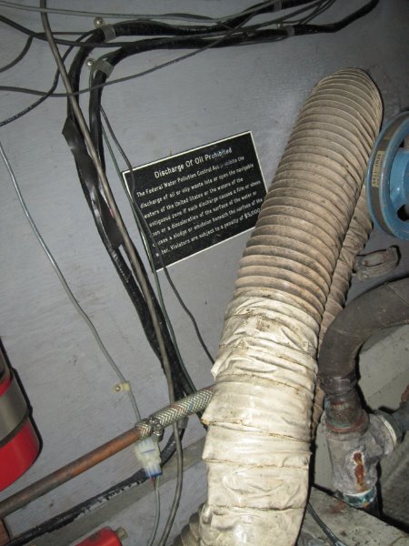

Even worse is putting a galvanized fitting in place. This is how our boat came to us -- note the rusty section of the "T" that was seeping salty water onto the bolts for the through hull!

WayWeGo wrote: Mon Mar 04, 2019 12:25 pm I note the rusty section of the "T" that was seeping salty water onto the bolts for the through hull!
That's mind boggling that someone would let their hose clamps get into the condition in those images. As for the T bolt clamps with the welded connection as opposed to the ones with the folded over tabs. Interesting theory, but if my clamps, anywhere on my boat were in a state where moisture might affect them, alarm bells would be ringing like crazy in my head. Why is there any moisture there at all and then solve that problem!! For me the advantage of the T bolt clamps is the holding power. The effect of moisture wouldn't be a consideration for me at least, since moisture just isn't allowed around any hose clamp fitting or any other fitting on the inside of my boat.
