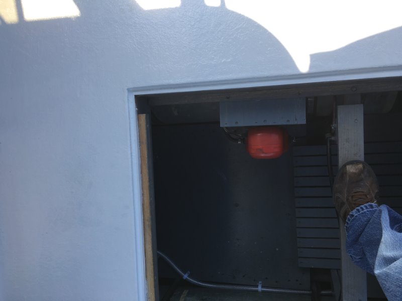

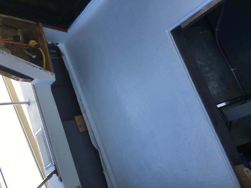

Fiberglassed the cockpit floor yesterday. Next is gelcoat and non skid. No pictures yesterday but it turned out really good. Still need to sand the bottom and recoat but I'm getting close to putting her in the water

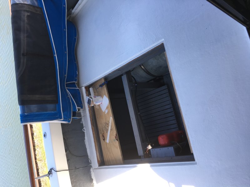

Two layer of 1.5 oz CSM over the flat deck and three layers around the perimeter for extra strength. I gave the ply a good sanding with 80 grit, coated it with vinylester resin liberally. After that set up I laid on the fiberglass with more vinylester resin. At least I have all the wood protected well till we get some good weather again. Going up to the boat on Thursday to finish installing the cabin roof gutter and then putting the canvas cover over the cockpit area so I can work even if the weather isn't perfect.

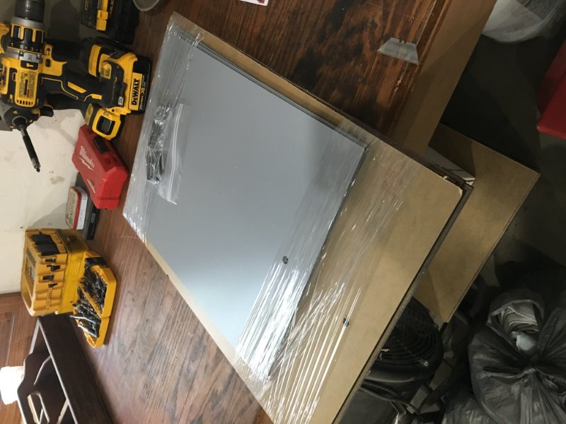

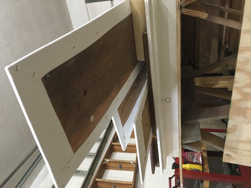

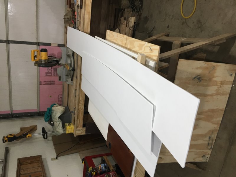

Just finished covering the cockpit combing panels. At least I think that's what they are called. Also I have the new sliding doors for the galley and head ready to install into the new tracks I put in last weekend. This week is bottom paint and gel coating the cockpit deck if the weather holds that is.

Really nice. Im going to do my kick boards out of 1/4 luan with frp board.
1974 f32 Sedan
Twin 233 Mercruisers
BradZ
Posts: 161
Post by BradZ »
How are you going to finish the edges of the luan? That's where all the moisture is going to get absorbed. After using contact adhesive and wrapping the edge with the vinyl covering I'm confident they will last another 40 years

BradZ wrote: Fri May 03, 2019 10:13 am How are you going to finish the edges of the luan? That's where all the moisture is going to get absorbed. After using contact adhesive and wrapping the edge with the vinyl covering I'm confident they will last another 40 years
Im going to resin the luan like i did with the rest of the deck. Also going to use a frp cap molding to help isolate the wood from water.

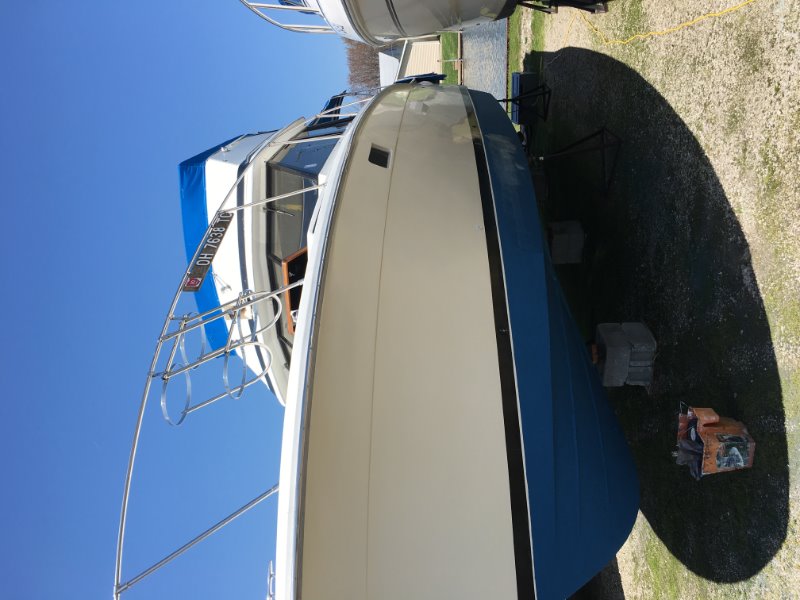

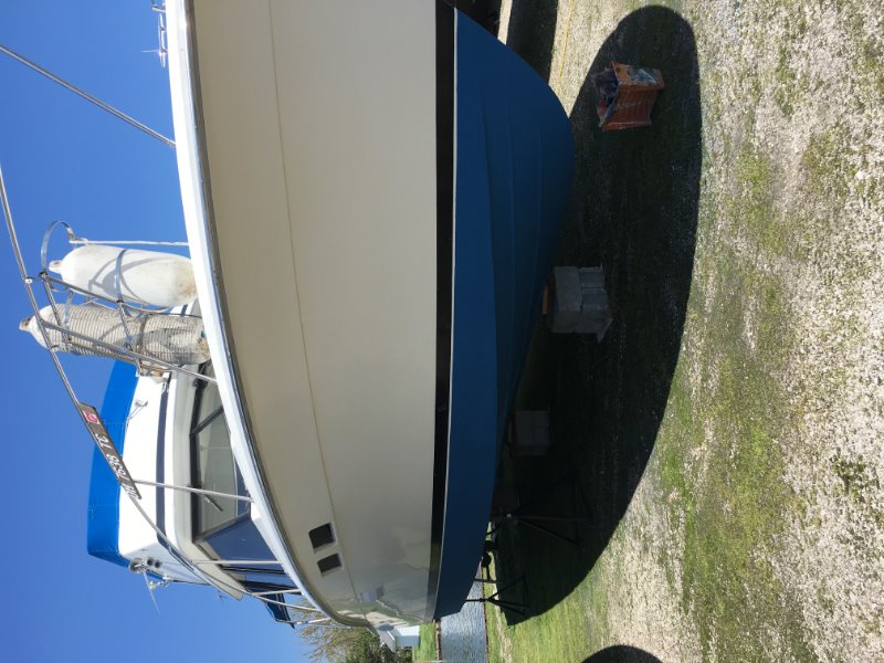

OK I had a good window of weather finally so I got the first coat of gelcoat down on the cockpit deck and cleaned up the bottom and gave her another fresh coat. I think a soda blasting is in her future though. I'm hoping to get the nonskid down next weekend and reinstall the bridge ladder so I can drop her in the water on Monday next week.

Really really nice. I want to soda blast the bottom next spring. Looks really really clean.

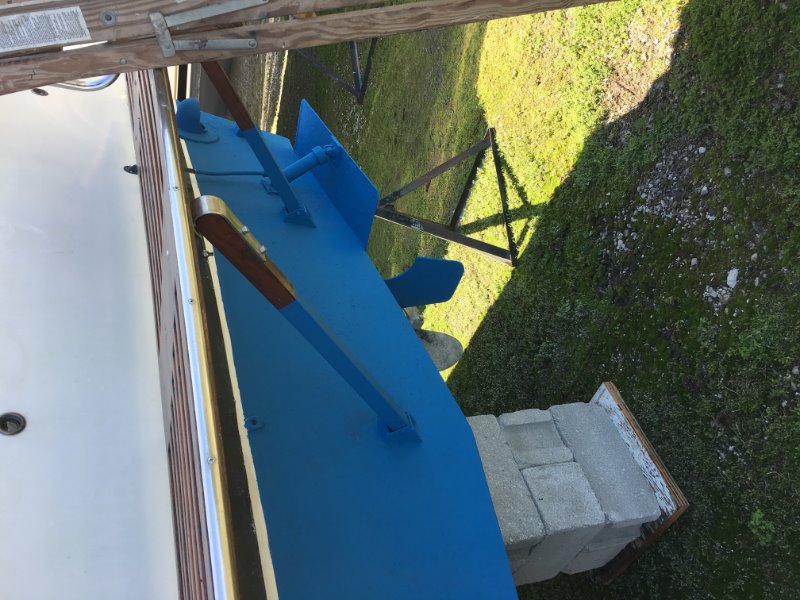

It looks like your boat is supported by hollow core cinder blocks. I have heard of them crumbling and would not use them myself. Wood blocks are much safer.
