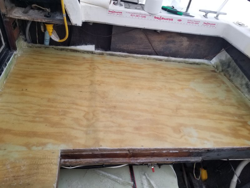

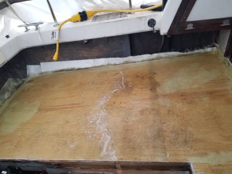

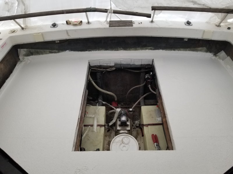

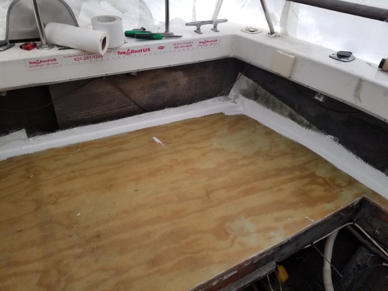

Location: Bronx, NY
Re: Cappy's f32 rehab
Post by Captrichc »
Hete are some pictures.
