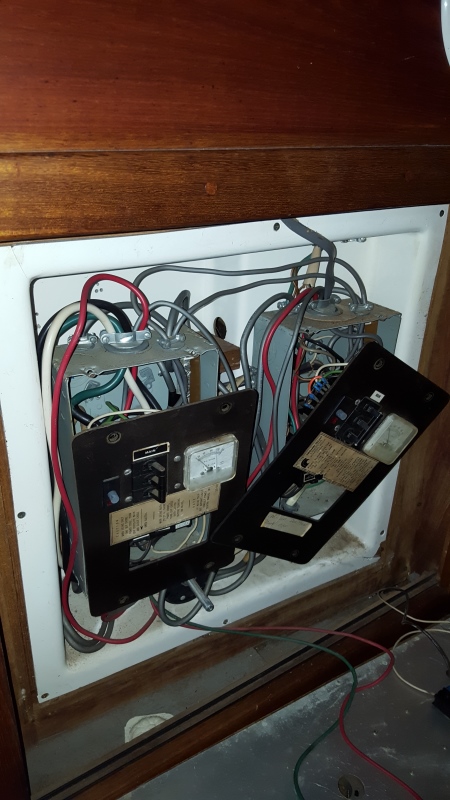

When you said romex, I was sure you were mistaken. However, zooming in on the terminal straps shows solid wire. That's not factory, is it? Are you sure that you don't want to replace that with boat cable???
Re: Oil & Water Restoration Thread
P-Dogg wrote:When you said romex, I was sure you were mistaken. However, zooming in on the terminal straps shows solid wire. That's not factory, is it? Are you sure that you don't want to replace that with boat cable???
Good eye , That yellow cable is not marine for sure .

Our F36 has Romex on all the distribution circuits and I suspect it is original. Everything I can see up to the mains is wired with stranded, but that is about all. We actually have two metal panel boxes with Masonite covers on ours:
AC Panel.jpg (167.38 KiB) Viewed 30633 times
Like oilandwater, a new distribution panel and wiring is on the horizon, just not sure when.

WayWeGo wrote:Our F36 has Romex on all the distribution circuits and I suspect it is original. Everything I can see up to the mains is wired with stranded, but that is about all. We actually have two metal panel boxes with Masonite covers on ours:
Way, ouch, that must have hurt opening up those panels.
Currently Trojan-less :?

Kind of strange how how the 73 and 77 are close to the same and the 75 is different . I guess one of the panels on way we goes 75 may have been added maybe by the dealer maybe the factory ?? I saw a early F36 that had 2 panels one on each side , as were the cords .
