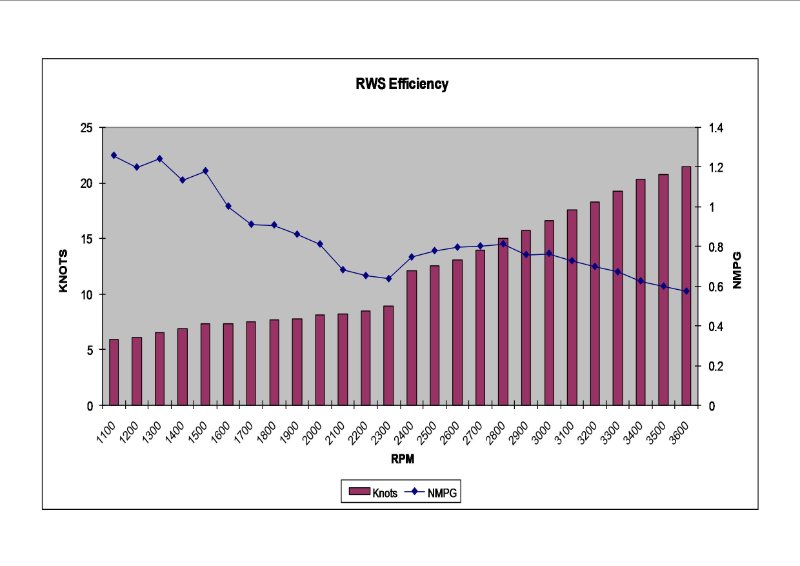

Re: 10M Express what is the best prop?
1983 Express same gears as you
my most efficient props were 4 blade 18 x 19
stock 9x24 trim tabs replaced with 12x24 tabs with 3" drop fins - this is a DIRECT, BOLT-ON REPLACEMENT
remove exhaust diverters
replace stock breathers(spark arrestors) with taller ones - BEACON MARINE
check and set spark advance with an ADVANCE TIMING LIGHT
