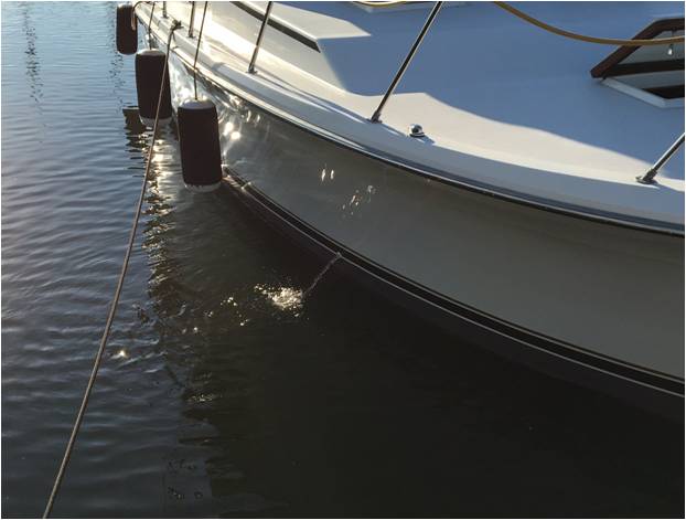

Ok... took way longer than it should have, but it feels good to see the boat finally being able to take a pee again!

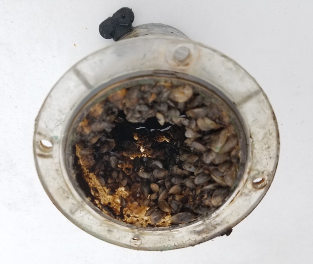

Re: F44 Cruisair not pumping water
At least you are not dealing with the accelerated growth from our nutrient laden Lake Okeechobee discharges here in Florida. It’s hot and the air is running nonstop, so this is about 2 weeks growth.
